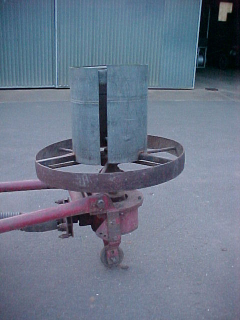

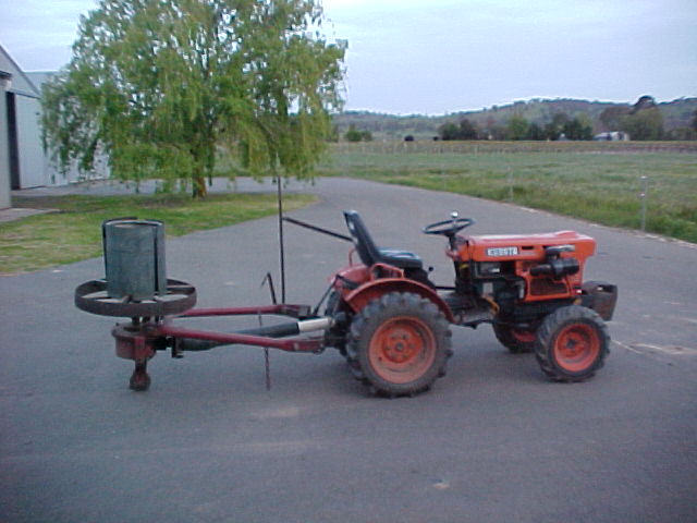

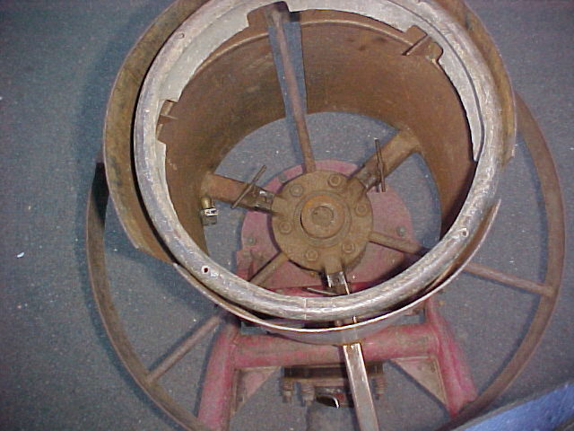

The 4wd B6100 is used for towing the 12V trailed sprayer pictured in the first post, but also for other jobs like this pto powered wire/drip hose winder.
View attachment 146844 When the wire or hose has been wound up the three sections of the cylinder can be released which allows the roll to be lifted off.
The post hole digger frame and gearbox in the above pics also has a bracket I've made which mounts the gearbox on its side. To the now horizontal output shaft I fit a tenching wheel which will dig a trench 18" deep x 3" wide.

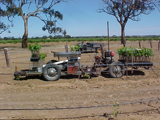

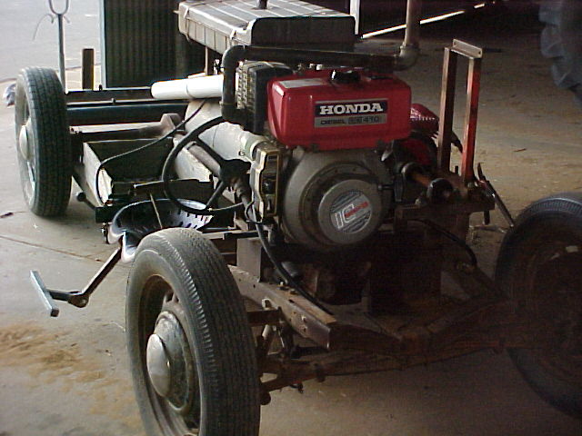

I bought the third B5100 earlier this year with a view to converting it to replace this buggy which we use for training young vines, tying up drip hose etc.
Don't know when I'll get time to do that!

Sorry the Winder pics didn't load correctly - here thay are.
