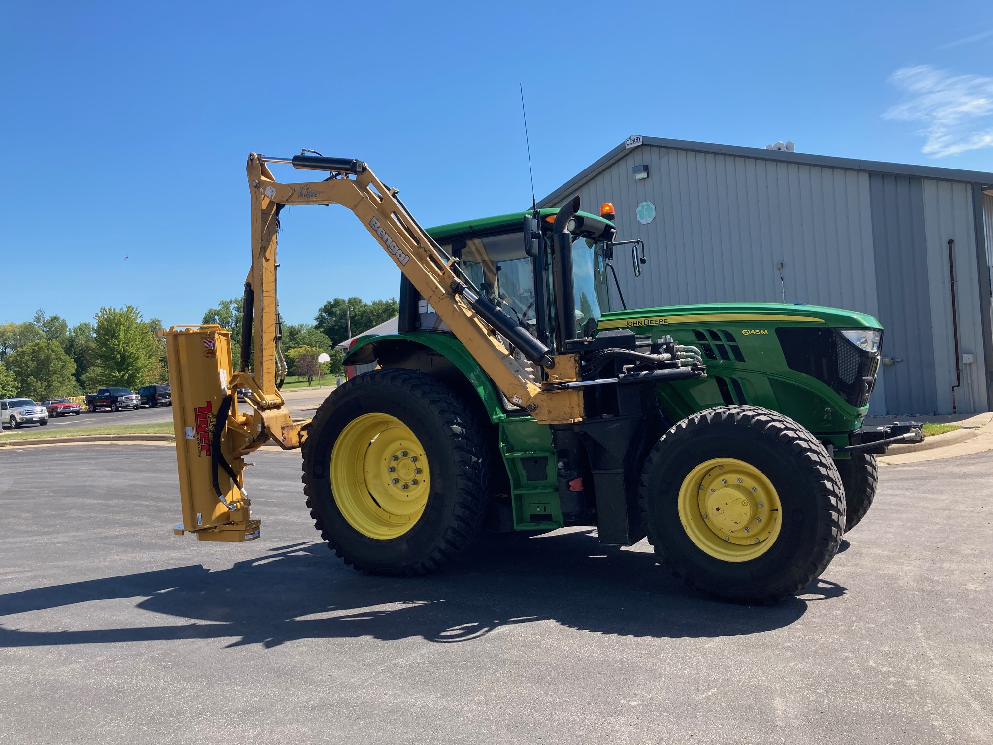

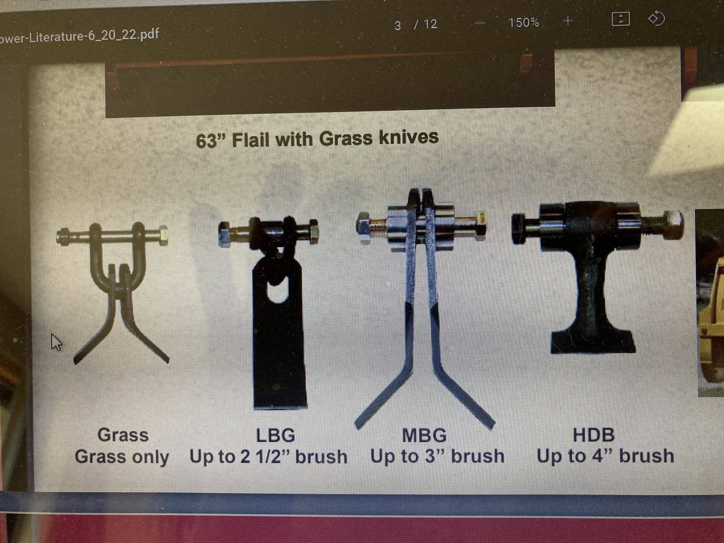

I do roadside mowing for a township near me with a 63" flail on a 24 foot boom, kinda a diesel therapy hustle retirement gig, from what your saying your flail has hammers. From info from Tiger Mowers manual hammers are for brush, my mower is set up with knives. Now Tiger says the knives that are on my flail are for grass but believe me I do a lot of tree trimming and brush cutting along with mowing chest high grass and cane. Here is a photo from the Tiger manual, again the "knives" I have are the ones on the left. Hope this is helpful.

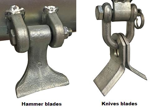

Knives will cut in either direction, hammers will not. If belts are tight and in good condition, and you're turning at correct PTO speed, then, to me, says that your hammers are on backwards. How long have you had the flail? Has it always done this, or just started? I have had two Titan (Chinese) flail mowers, one PTO driven (sold), and currently a hydraulic driven for skid steer. Both have hammers, and work flawlessly.
Not all knives are reversible, but many are.
