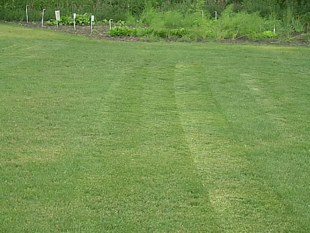

Ok that worked. If you look at the picture you can see how all 3 blades are cutting on an angle. The blade on the right of the piture is the worst then the one on the left is not as bad. The middle blade has a very slight angle that I could live with.

Here is a little better veiw of my problem.

If you are using new, true/flat blades, and they do not measure the same distance tot he concrete all the way around.. the spindle is not installed perp tot he deck.. or the deck is slightly bowed/convex/cave... get a ruler out and start making measurements..

Your pictures tell it all. Your deck is bent! Something has happened to it that has caused the spindle mounting points to no longer be in the same plane. If you had to replace two warped blades, I'll bet you money that during shipping or set up, someone managed to bend both your blades and the mounting pads of the spindles. The spindle assemblies are very stout, so I'm not surprised the deck took the beating.
As a mechanical engineer, I'd love for the dealer/service guys to explain how a mower deck can achieve that cut and be considered OK and not bent. Bent blades would still cut level, but might be lower or higher than the one next to it. Yours are definitely angled relative to each other. Good Luck.

I noticed that you seem to have a slope there...does it "scalp" on the SAME side when going in either direction across the lawn? Maybe the larger deck is just TOO wide for that slope? I'm just reaching for explanations here...

Hi joerocker. The lawn is almost completely flat there. The scalping is always on the same side of the mower.

My guess, helped along by Soundguy's thoughts RE the blades being bent during shipping due to blocks under the deck - If enough force was applied to bend the blades, surely the spindles are crooked. Think of the leverage gain you'd get over the length of the blade.
And over that length, the spindles wouldn't have to be visibly crooked to make a large difference in height at the tip of the blade.
