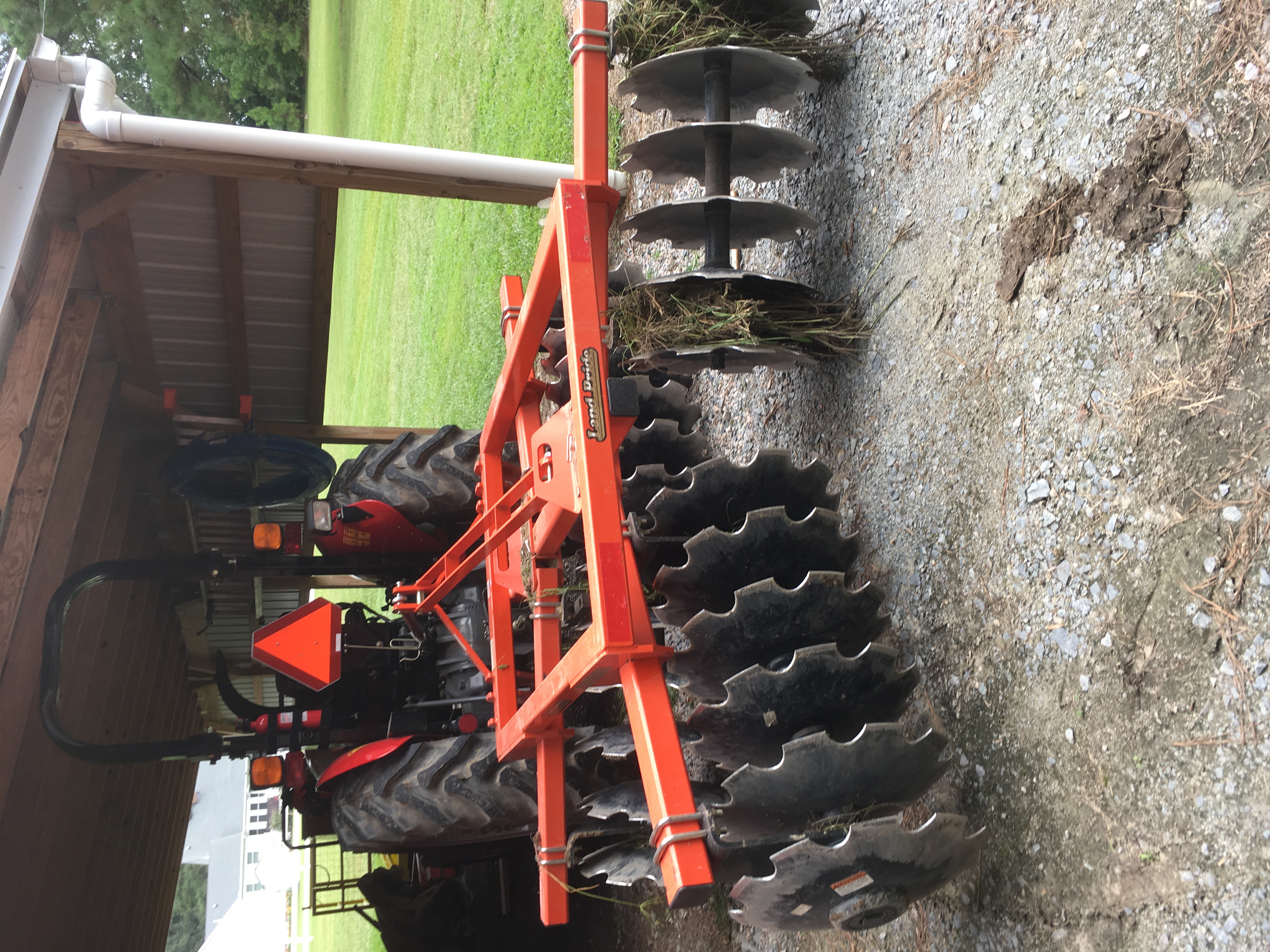

Before I spent a great deal of money buying a front weight rack and weights for my larger Massey, my first attempts
at pulling a Land Pride disc harrow were real eye openers at the end of the row. Even with disc raised tractor was a bear to turn, and had to
throttle way down, since there was almost no weight on the front, relatively. I had not used steering brakes for 50 years, since I plowed snow as a teenager with a JD B.
No diff lock on that so you had to use the brakes to keep from digging in and getting stuck in the snow.
Fast forward 50 years and now I have a challenging and frankly not very safe situation trying to steer the tractor, plus not running into neighbor's bean patch planted too close to where I was,
not enough head room. So...I tried using the steering brakes and whooeeee, I was spinning around at the end of the row like a teacup. Front wheels would almost lift off the ground and I got pretty good timing it as to when to stop the spin. Ok, now with the proper weights up front I don't do that any more, nor would I want to. You really have to hang on and with severe arthritis, it's just too hard on me.
I started doing what was previously referred to about half way through, going up about three or four rows so I didn't have to hit the brakes at all.
