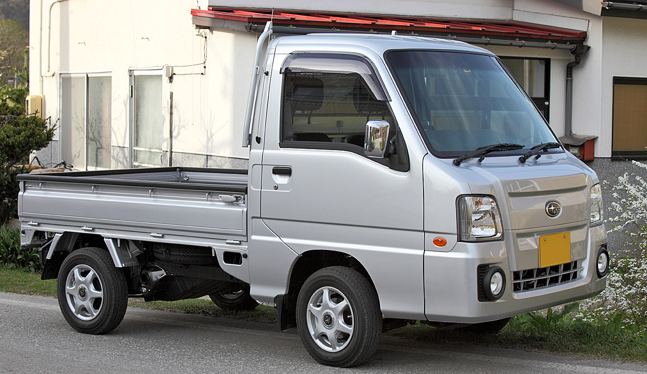

I'd love to have one of the Japanese mini-trucks, but by the time they get imported here, they are usually 15-20 years old and still cost an awful lot! I think the majority of the ones I've seen (if not all) are 4WD, not front WD, and, of course, nearly all are right hand drive.

Everyone's ideal truck is probably made somewhere in the world but not available in the US. For example, I recently ran across this Subaru pickup on the internet.
Looks like it could take quite a nose dive if you had to hit the brakes hard.
