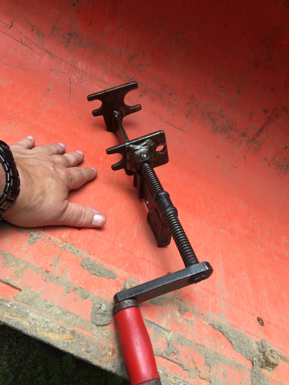

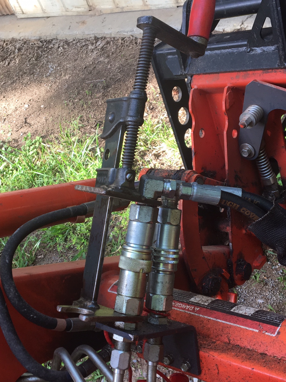

Made the clamping tool for ag couples for a Kubota B20 backhoe years ago that was awkward to connect. Also fit flat face connectors on the big tractor grapple.
Doesn’t take much force to connect under pressure but more than I can do by hand anymore. See a fellow on eBay is selling a similar clamp.
Bought a Waite pressure reliever tool last year. Has scared the flat face couplers into behaving and not had to use it yet. It would pretty easy to make something like it.
View attachment 656397 View attachment 656398
Doesn稚 take much force to connect under pressure but more than I can do by hand anymore. See a fellow on eBay is selling a similar clamp.
Waite Hydraulic Decompression Tool Video - YouTube

Turn off tractor. Turn key to run position without starting tractor. Use the electrical switches to cycle valves. You should hear the valves operating. You can actually hear the difference when the pressure is relived. Try to connect. Every once in a while if the tractor is hot or after connecting one of the lines and I don’t move fast enough, I may have to cycle the valves again. So l leave the key on without the tractor running while I am connecting.
Same for connecting rear remotes if electrically operated.
Manually operated rear remotes levers must be operated with the control lever while the tractor is off to relieve pressure. One of my tractors I used a rear remote to operate the FEL grapple.
Implements I connected the lines together when storing if I can. Set out of the sun if possible. Still had to loosen a fitting to relive pressure sometimes before making the clamping tool. At first it was frustrating leaning new tips and tricks.
