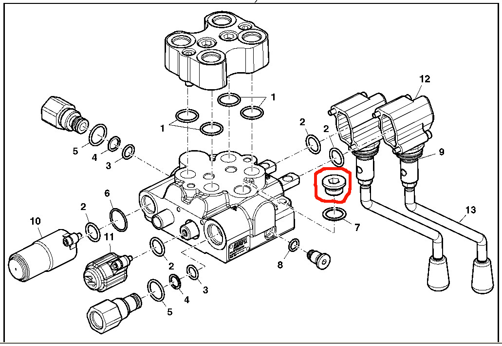

Re the Dual Rear SCV valve pictured below from the JD Parts Catalog (that's I hope being installed even as we speak)--Is the plug I circled in red the power beyond output port on this valve? Or is there even a PB port on this valve? Where does the return side of the PB hose set go--directly to the tank? Trying to get myself educated on future PB possibilities after these new rear remotes are installed.
Did you guys forget about this part of my original question? I ask all this because I was thinking that with two control valves now, maybe I'll have a choice where to tap in for PB: the original joystick loader valve, or this new one in the back. Knowing the answer could make a big difference in how I can conveniently place connectors, route hoses, etc. if I decide to install power beyond later.
If nobody knows for sure, that's ok. When I pick up the tractor I plan to take this diagram with me and ask the hydraulics wiz at the dealer the same question.
Clearly I need to do more homework on power beyond, a subject which is pretty much ignored in JD's manuals.

I picked up the tractor this afternoon, looks like the dealer did a nice job of installing all the hardlines and stuff, the whole thing looks really good and he claims it tested fine, although I haven't tried it out since I don't have my top and tilt yet. I like the mount JD provides in the kit, handy but out of the way of my elbow, and the wrist rest is a nice feature. The left hand set has float, the other does not. FWIW, the kit was $720 and arrived only three days after I ordered it, and the install was about 3 hours of actual shop time.
The mechanic who did the install verified that the plug I had circled in red was in fact the PB port for this valve. It's right out there easy to get to if I want to use it in the future.
