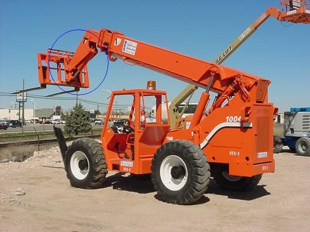

How "high dollar" are they? Well, as an example, the fork tilt cylinder circled in blue in this photo of the telehandler costs us about $1600....and that's dealer cost. We've had them damaged before and the customer gets upset when they get a bill because they "can buy a cylinder that size for $200 over at Fleet Farm or TSC...."

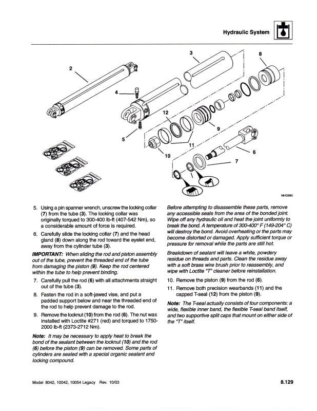

And here's an exploded view of the lift/lower cylinder. The counterbalance and pilot check valves, (items 4 and 5), are installed in both cylinders....which is why it's important to not try and repair/adjust them.
   / Why not check valves in FEL? #36
Good illustration to show the seals internally.....especially the 4 piece capped piston seal and wear bands on the piston head.....you'd never see this style on a tractor cyl.....the technology is here but mfg's wont spend the money for the cost of these seals......that's what it takes to make a quality cyl....
As an owner, one of the problems of all this hydraulic equipment is you hope that your tractor has the best in it but reality sets in when you have low hours and it's time to repack cyls......without mentioning any names some small tractor mfgr's will use only orings and backup rings for piston seals....that's great for the hyd repair business but bad for "Joe Homeowner"
