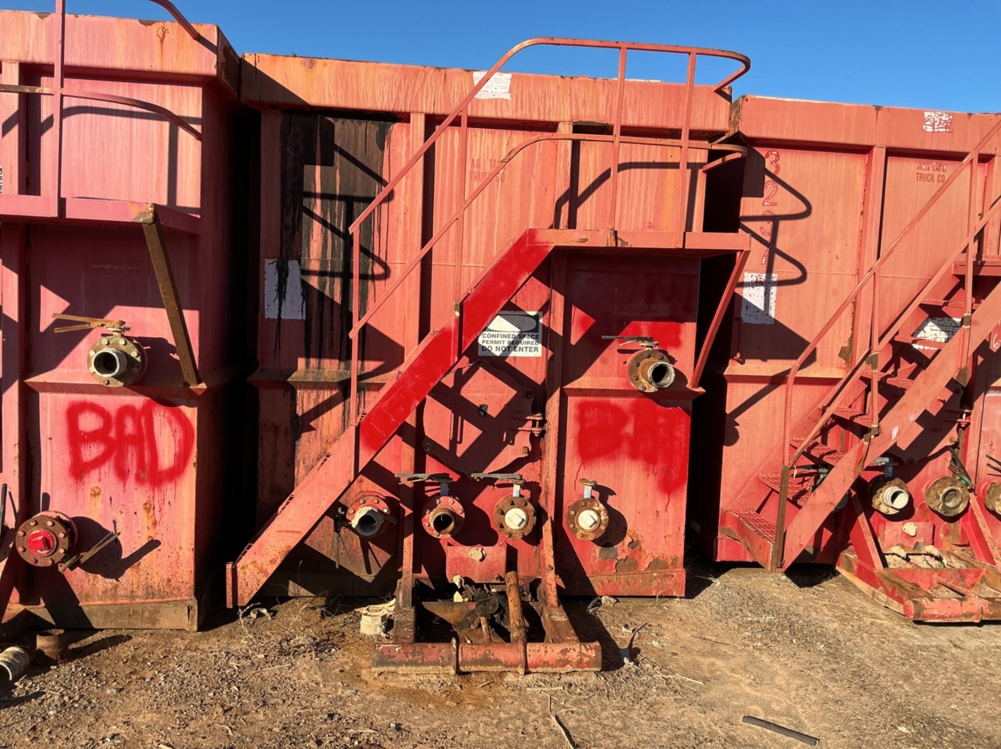

In theory, you could use a water soluble and biodegradable Machining cutting fluid concentrate. Maybe a gallon per tire mixed with water. I was considering that and then I realized I already owned a huge steel box I wasn't using.
