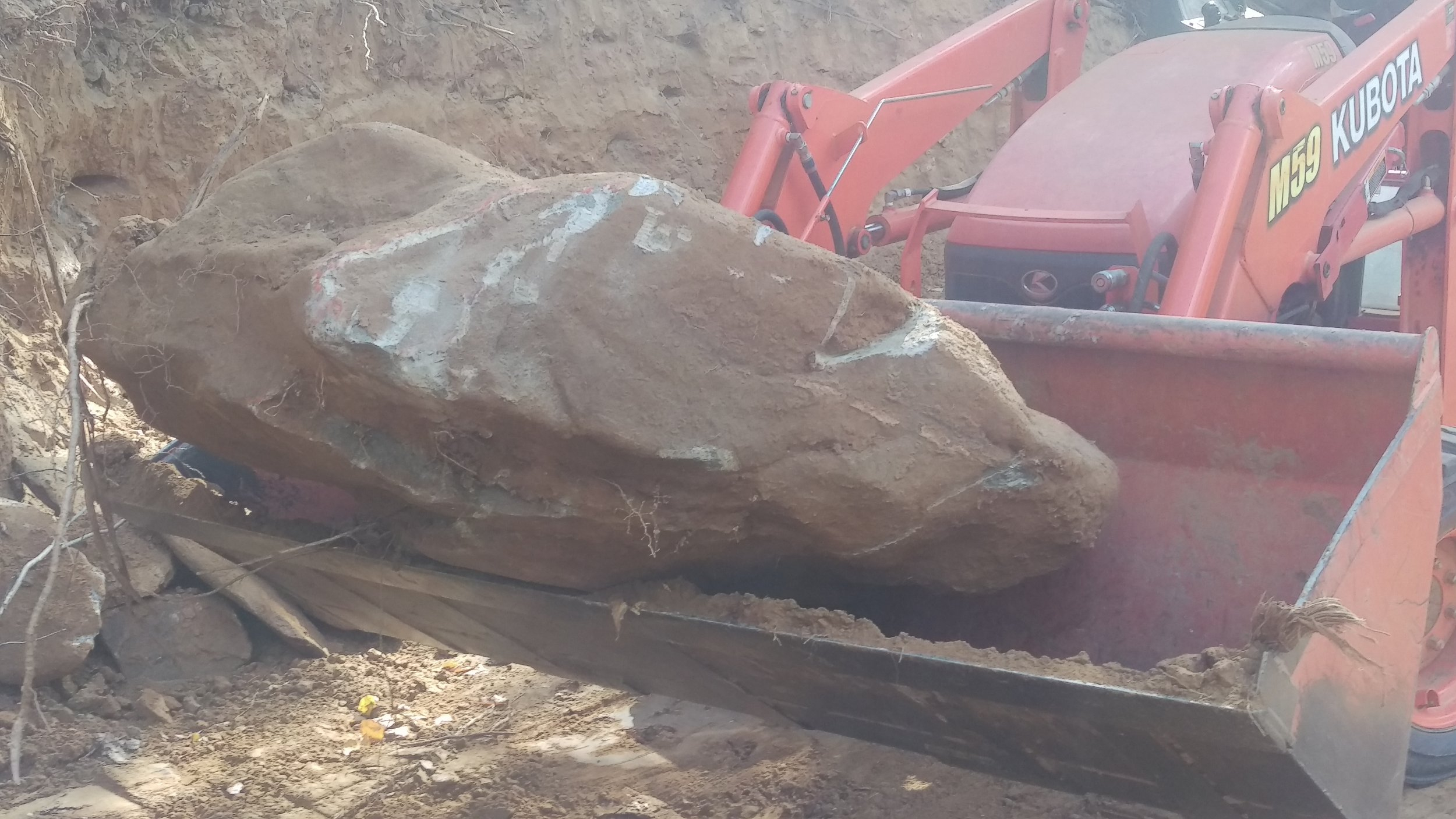

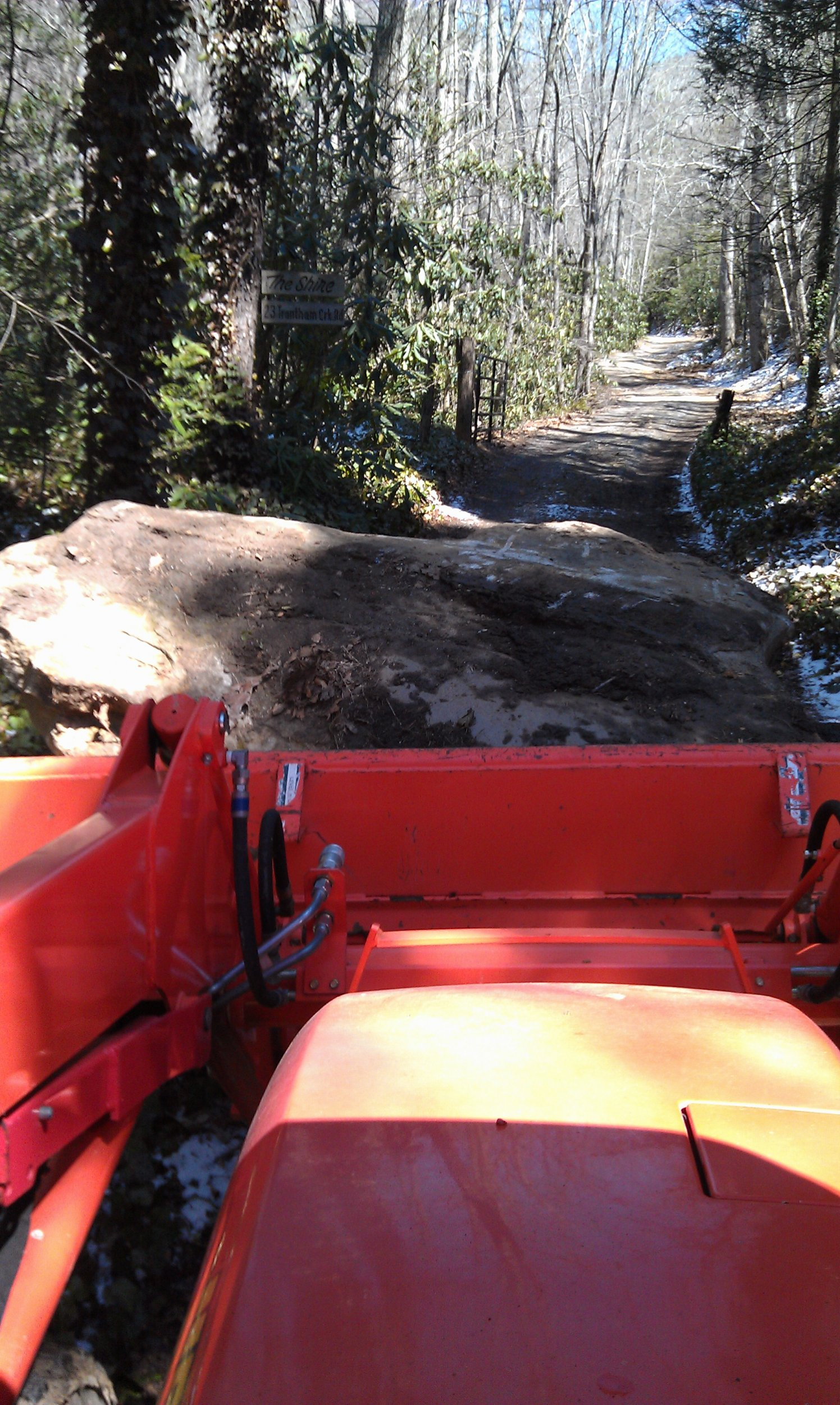

My used 2008 M59 came with beet juice loaded tires, which dealer didn't tell me about, and I only learned when I went to put air into a rear tire and purple juice ran out. I have never had any issues with tires, rims, or valves and would re-use the beet juice again if I have to replace the tires due to age or damage. Loaded tires are a huge improvement when carrying a full loader bucket ( pic below ) or when traveling over incline with full loader. Ballasted tires significantly lower the center of gravity of working machine. I have attached several data sheets for tire loading and tire volumes. I won't use the following :Salt because it enables galvanic corrosion and results in short rim life along as well as poisons ground when leaked. Methanol is a contact poison and doesn't really add weight since its sole purpose is to prevent water from freezing. Antifreeze ( ethylene glycol ) is sweet tasting and lethal to pets and local animals when it leaks onto ground.
Beet juice is thick, like syrup, so it is heavy per unit volume and must be put in with a gear pump. Most installers won't add beat juice when temps are cold because it gets thicker and hard to pump.
The left two pics are rock in a 84 inch wide bucket. Even with loaded rear tires ( 589 lbs beet juice per tire ) and a backhoe, the rear end got pretty light and would bounce. Not a pleasant sensation.
Hope this helps.
