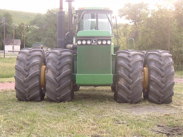

I was thinking of this thread and remembered the old Ford County tractors that had same size front and rear tires. Basically they were Ford tractors converted to 4wd. Here is a Super 4, it looks neat and would have great traction but unless you have 4 wheel steer, brake steering or an articulation joint it will take a lot of room to turn around.
   / Why Small Front Tires? #19
:rolleyes:
