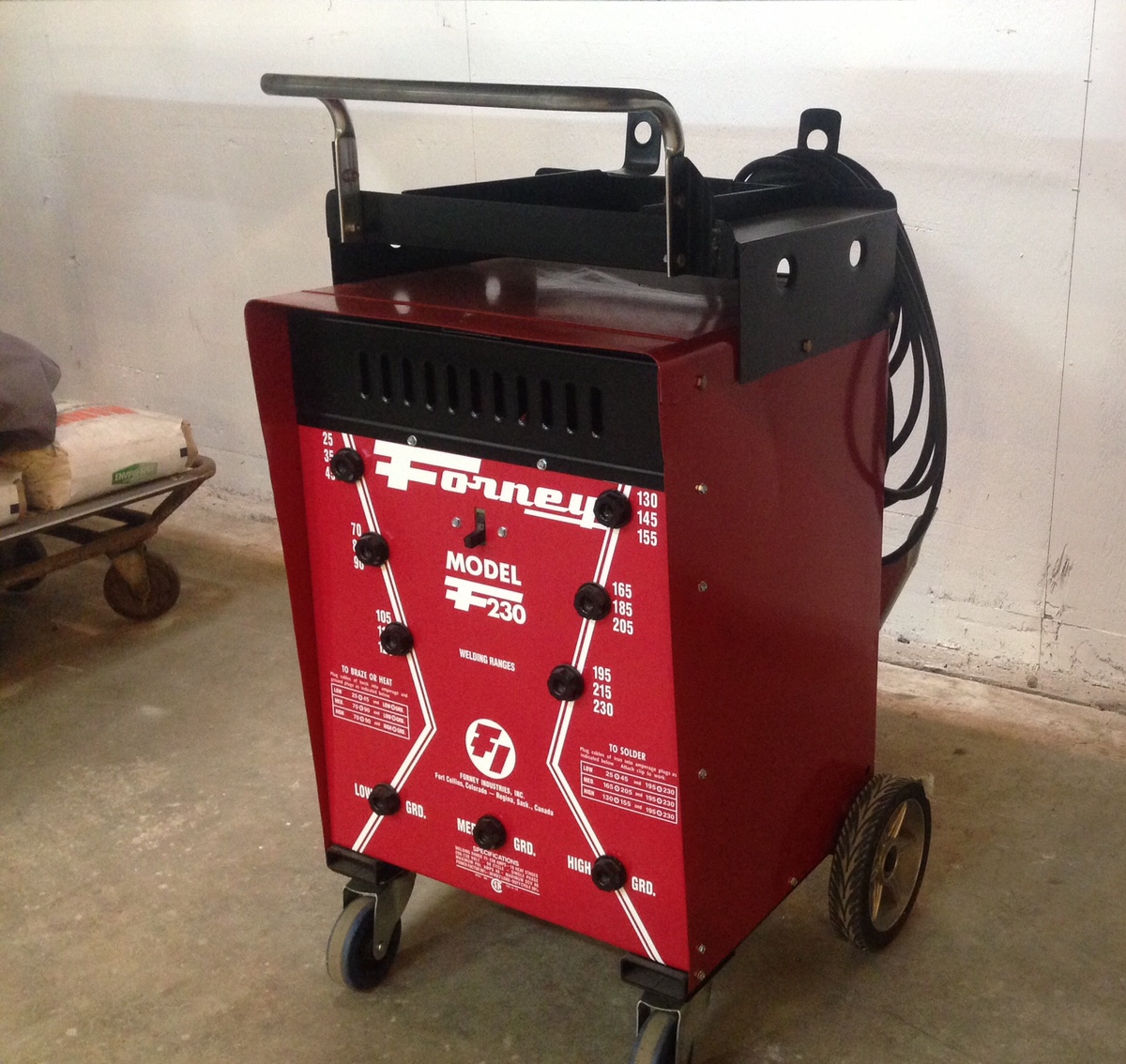

I still have my AC buzz box. I never use it anymore but I’d be fine if it was all I had. It’s the only welder I used for over 50 years.
