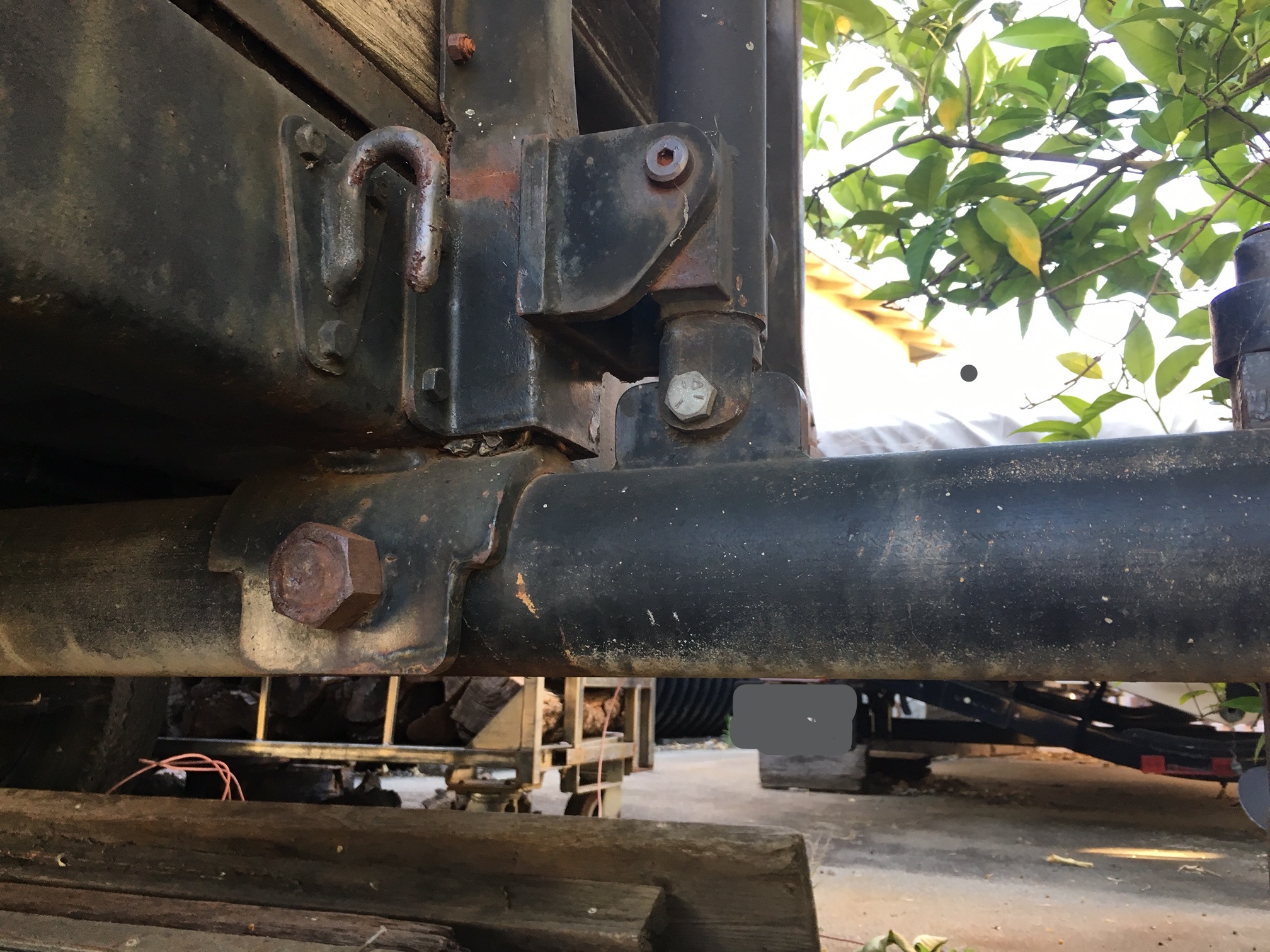

When I built my dump trailer I decided on one axle because it let me use the axle wheel bearings as the pivot point.
With two axles the dump pivot would require more hardware including a pivot or hinge.
I was asked to post pictures of the pivot point and how the box attaches to the tongue...
I built the 5x8 box dump trailer back around 1983... it uses a camper jack to life the box.
(Note: The first picture keeps posting upside down no matter how I post)
