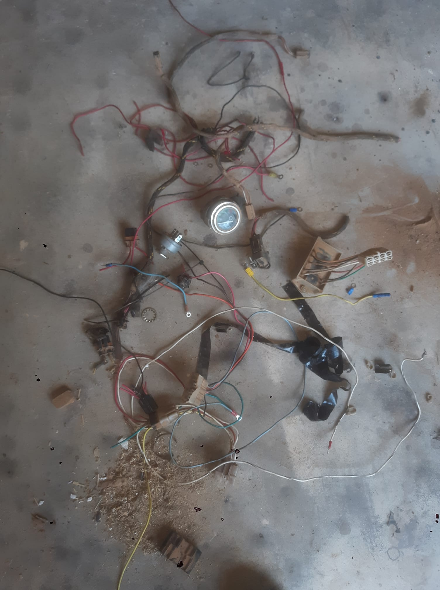

The heat slowed me down, we've been hitting the low hundreds and the humidity makes it hard to breath. I worked on it in the mornings, but then I would get too hot and my brain would become unreliable. I finally figured it all out yesterday morning and I was able to mow for a couple of hours.
I didn't put the water temperature gauge back in, but I saved it and I plan on installing it. I also have to put all the metal back on for the rear bumper. It's too light without it and hard to control while mowing.
Here is what I pulled out of it. Most of the wiring was for safety switches. Some of the wires change color for no apparent reason other then to confuse me. There where 4 wire harnesses that some of the wires went through, others would go through 2 or 3 of them.
The best feeling was when I put the multi meter on the battery while it was running and I saw the voltage increase!!!!
