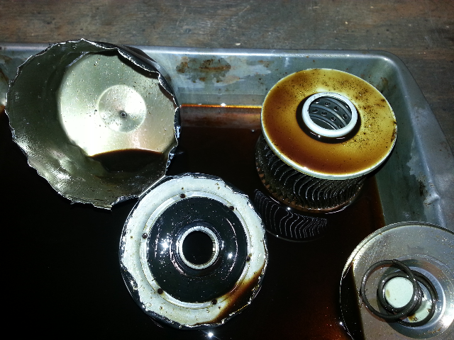

It apperars to be a filter from a quick lube place. Called a Lubeliner.
Chris
So it was a cheap filter that was probably not really good for 3k. I have noticed alot of those quick lube filters are smaller than a quality filter like a wix, hard to tell what they look like on the inside. Alot of the time those quick lube places just throw whatever oil in too.

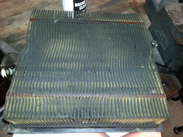

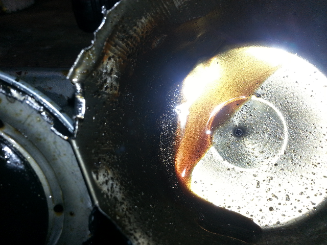

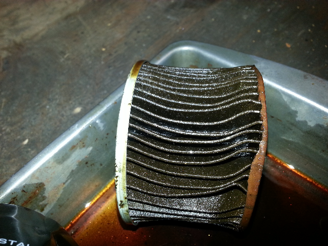

As promised I cut open the filter and changed the air filter today between battling a blizzard. Here are the pics.
Chris

I was surprised the filter actually had a spring in it. I bet the trans has never been serviced either.

where was he driving to have the air filter look like that? Even if he never changed it, that is only 68k on an air filter... still surprising to see it that black. I live on a gravel road and am exposed to a lot of dust. I change the air filter around 15-20k and it never really looks like it needs to be changed. Never had even come close to anything like that.

Not sure where he drives. He lives on the north side of Cincy.
