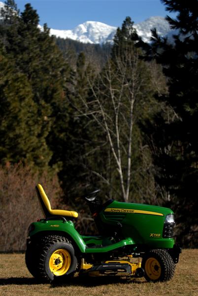

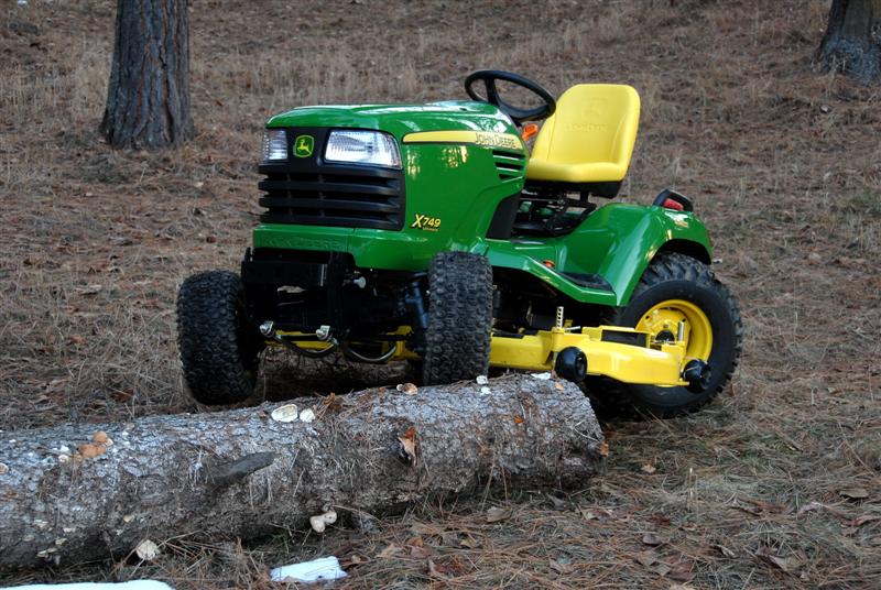

I purchased this X749 for mowing on the slopes and around trees. So far it is great maneuvering and is much more stable than my 2520 on the slopes. With AWD and 4WS traction is great! The AWD allows for different speeds to prevent tearing up the grass on turns. It is not zero turn, but close enough for me...

   / Why zero-turn mowers? #62
Thanks for posting the shots of the JD, Skidoo. I was advised by one dealer that the lawn tractors are better on slopes than the ztr's. That's an issue for me but need to check out whether it's true.
And that's one beautiful view in the second shot you posted.

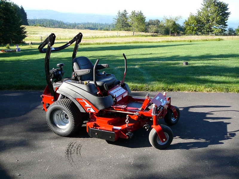

How steep is the slope on the back side of your pond? I am concerned about the surplus downhill wheel torque that would have to be maintained to prevent the ztr turning downhill if the ztr is forward balanced as they appear. If the topside wheel gets light there is nothing to react against to make uphill course correction to counter the front trying to swing downhill. A conventionally steered tractor does not have this problem since the wheels can turn uphill and with 4w assist will pull the front in that direction. The key issue is that the the ztr relies on differential wheel torque to steer, and hills limit the ability to apply this. Can they be steered straight course on a 30 degree cross slope like my BX1500 can? I can even drive at the edge of the Lake on such a slope.
larry
