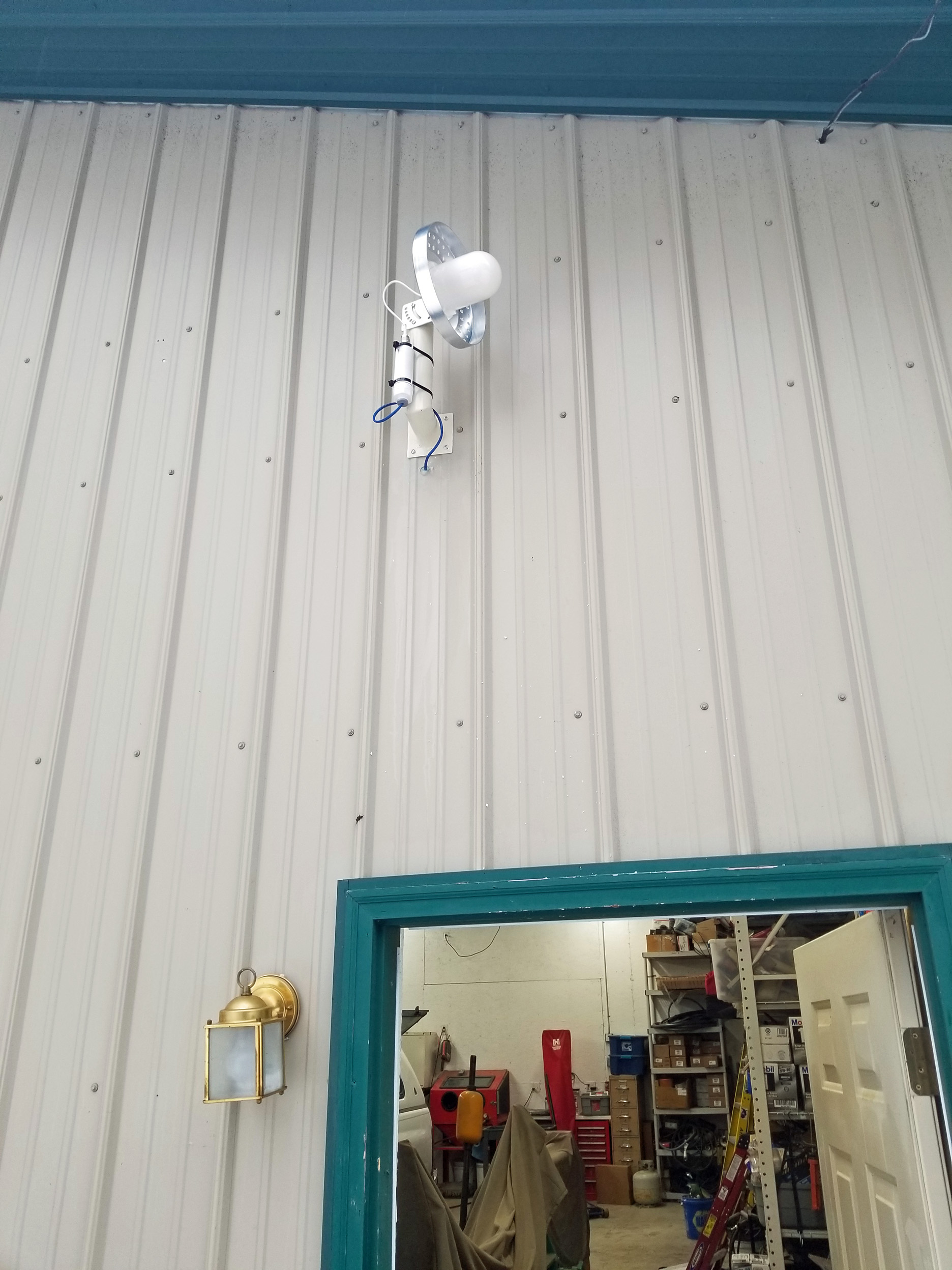

i tried several other things. this is what worked. it is an antenna, specifically for wifi. now my signal in shop is exactly the same as signal in house near wifi unit. i can also now use my cell phone within the shop.
i just remeasured to make sure and its about 320 feet between shop and house. the house router is in office which is furthest part of house away from shop. So this antenna is getting signal from deep within my house. impressed.
When all else fails, put up an antenna:thumbsup:

I may have missed it, what was your distance? Metal building?
Thx
200 ft maybe and a metal building. I can’t remember without reading the specs, but this thing will “broadcast” antenna to antenna a long ways!
