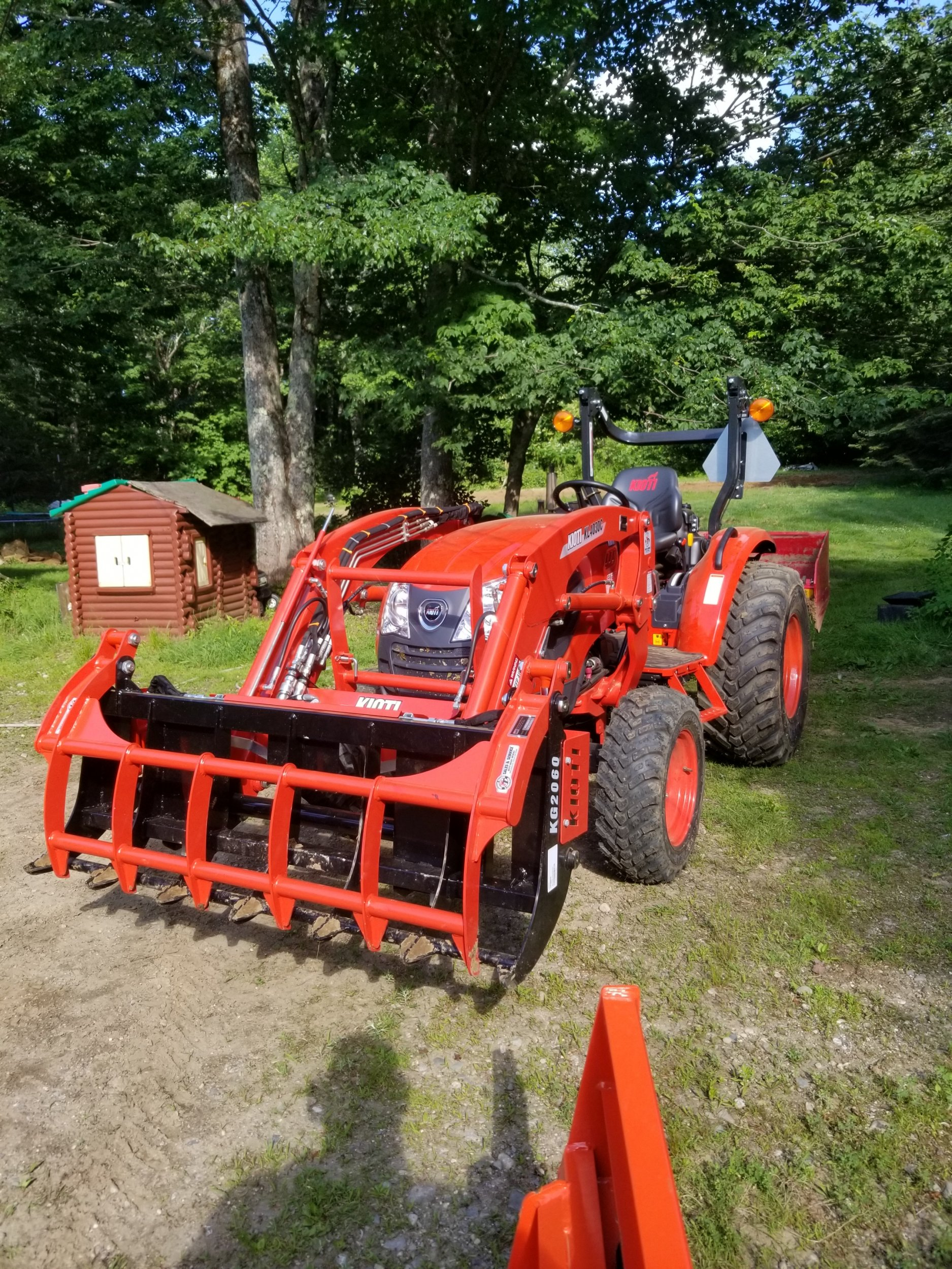

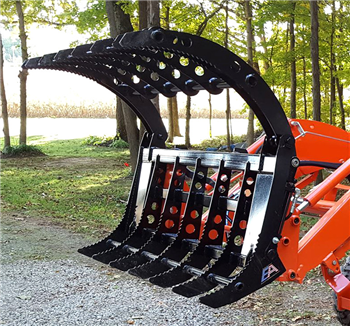

I have a EA 55 long bottom grapple, I had to wait a long time and it was definitely worth the wait but I got mine pre-covid. I think the EA will be hard to beat in the size/strength vs weight department.

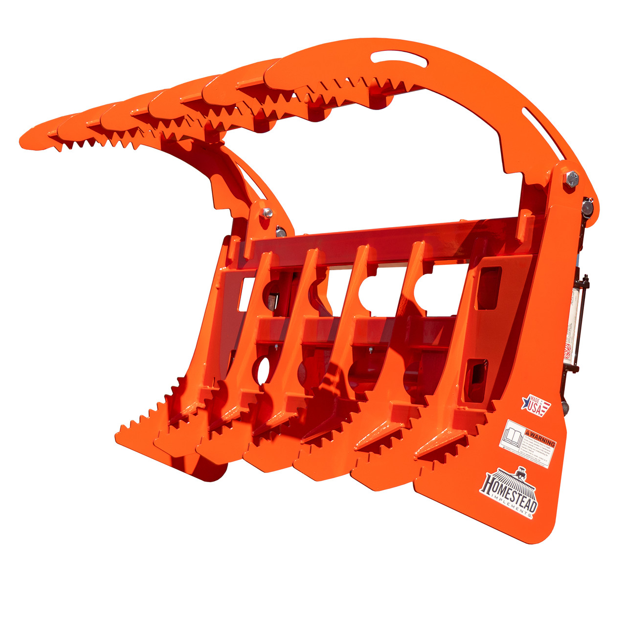

When choosing a grapple it is important to consider FEL lift capacity vs weight of grapple. I have a Homestead Implement grapple for a compact tractor 72'' wide. But they have smaller ones Sub-Compact Tractor Grapple Independence Series
Thanks for the input. (y) edit: Homestead "Sub-Compact Tractor Grapple Independence Series" is 54", 190 lbs, and $1780, so thanks for the suggestion! :D
I have a Kioti CK2610, FEL lift is 1800, EA wicked 55 is 239 lb, so I selected it based on that.
Homestead "Sub-Compact Tractor Grapple Independence Series":

Your CK2610 will run any hydraulic or loader attachment the other CK's will run; despite it's small engine the machine isn't a subcompact and you'd be limiting yourself with subcompact attachments.
   / Wicked 55 root rake grapple on a 25HP compact? #8
This is more in line with what it's capable of; with that said, EA is a great manufacturer and if I hadn't bundled my grapple in at the dealer I would have gone with a Wicked.
