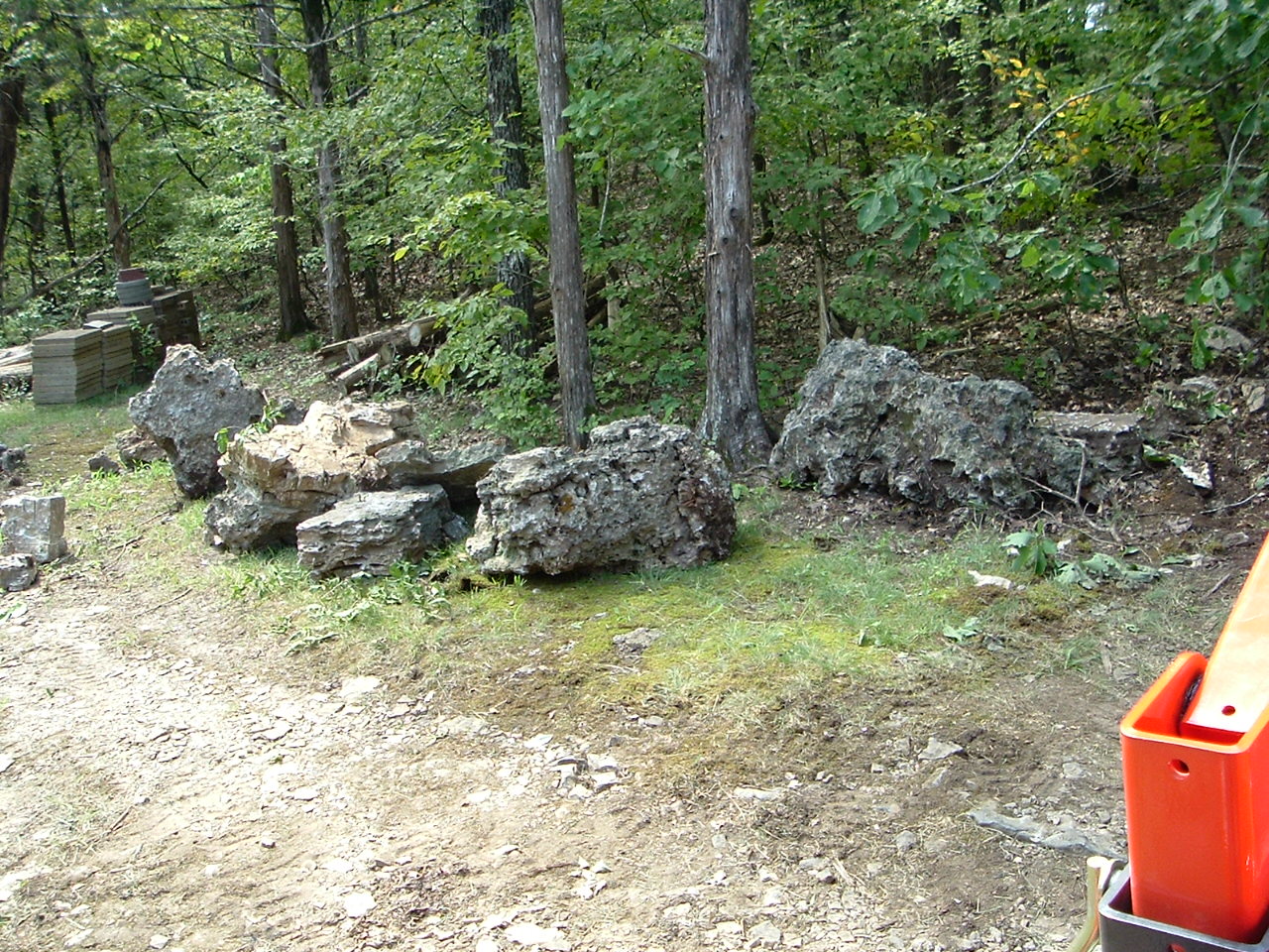

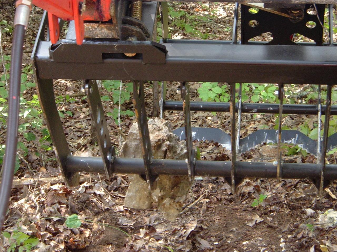

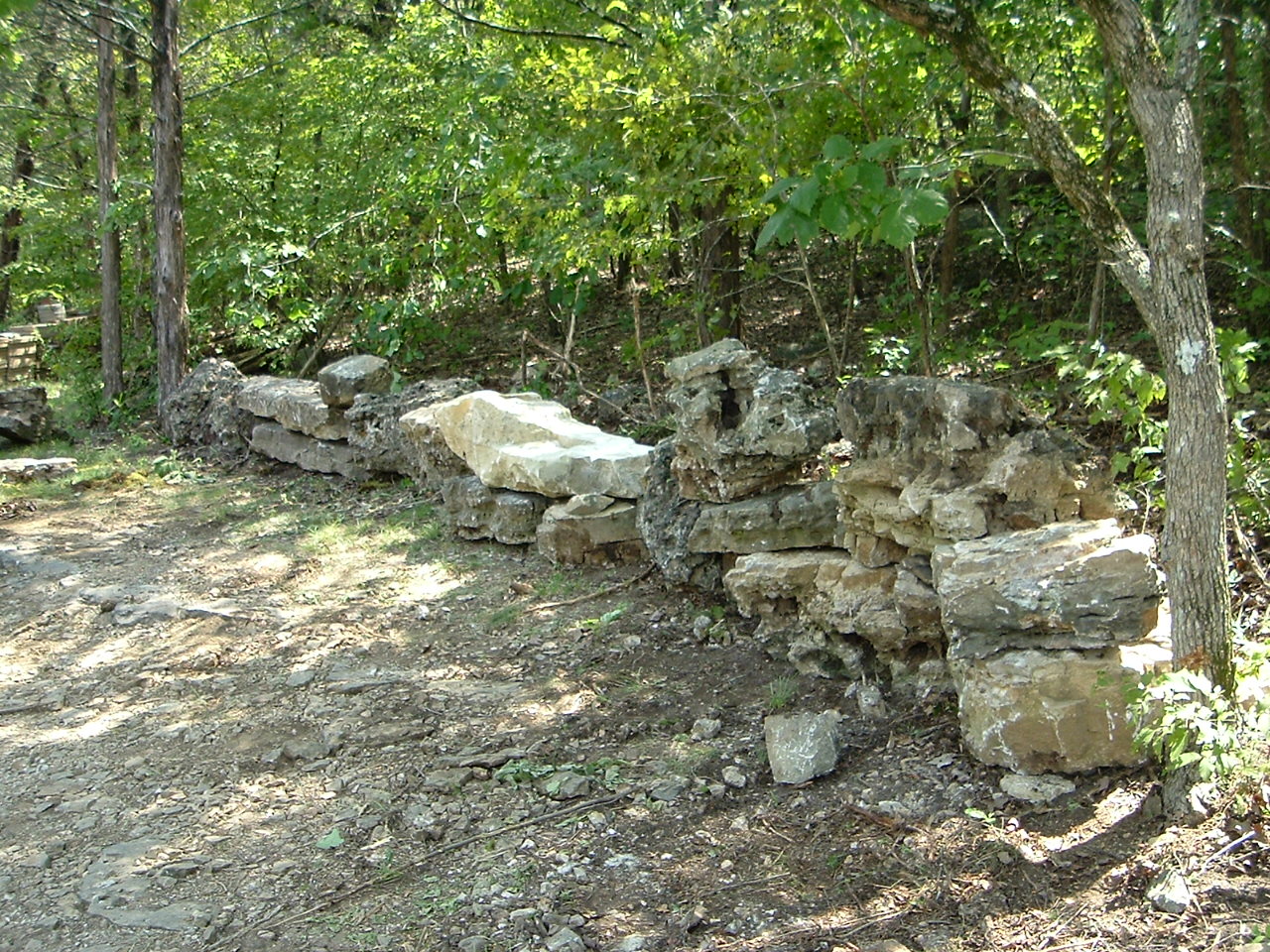

Great pics! I've told people that our grapples will work just fine to move rocks. Now we have proof!
Ted used his to move some rocks last week.....bet he didn't take any pics though.

They do move rock quite well, But I was surprised at how small of a rock I could move. You just have to be careful not to crush them. You "dump" the grapple straight down and you can still see the outside tines of the lid, and with your Hydrostat equipped tractor (works the best to creep) you creep up on the rock, slowly close the lid and lift straight up. It becomes intuitive after some practice. It works pretty much the same for large rocks also, and that technique also allows you to set a rock gently on the ground exactly where you want it. Just set it straight down positioned exactly where you want it by creeping forward or reverse or turning the wheel for left and right position. Gently lower the lift and let the rock settle before releasing the lid.

Well guys, unlike some "other kinds of envy", grapple envy can be fixed pretty easily:D A quick call to Travis at Everything Attachments, and he will fix you up. A grapple is just one more blade in the "jackknife", but it does bring a dimension that I have never had before. I have drooled over guys with backhoes moving and placing rocks, but now I can do it too. I moved a lot of rocks with forks, the last 2 years, but it is a lot more work to get things lined up and get under the rocks just right to balance them.. The grapple makes it easy, and you can actually set them down easily without all the getting off and man-handling, and using a bar to move them into place.
