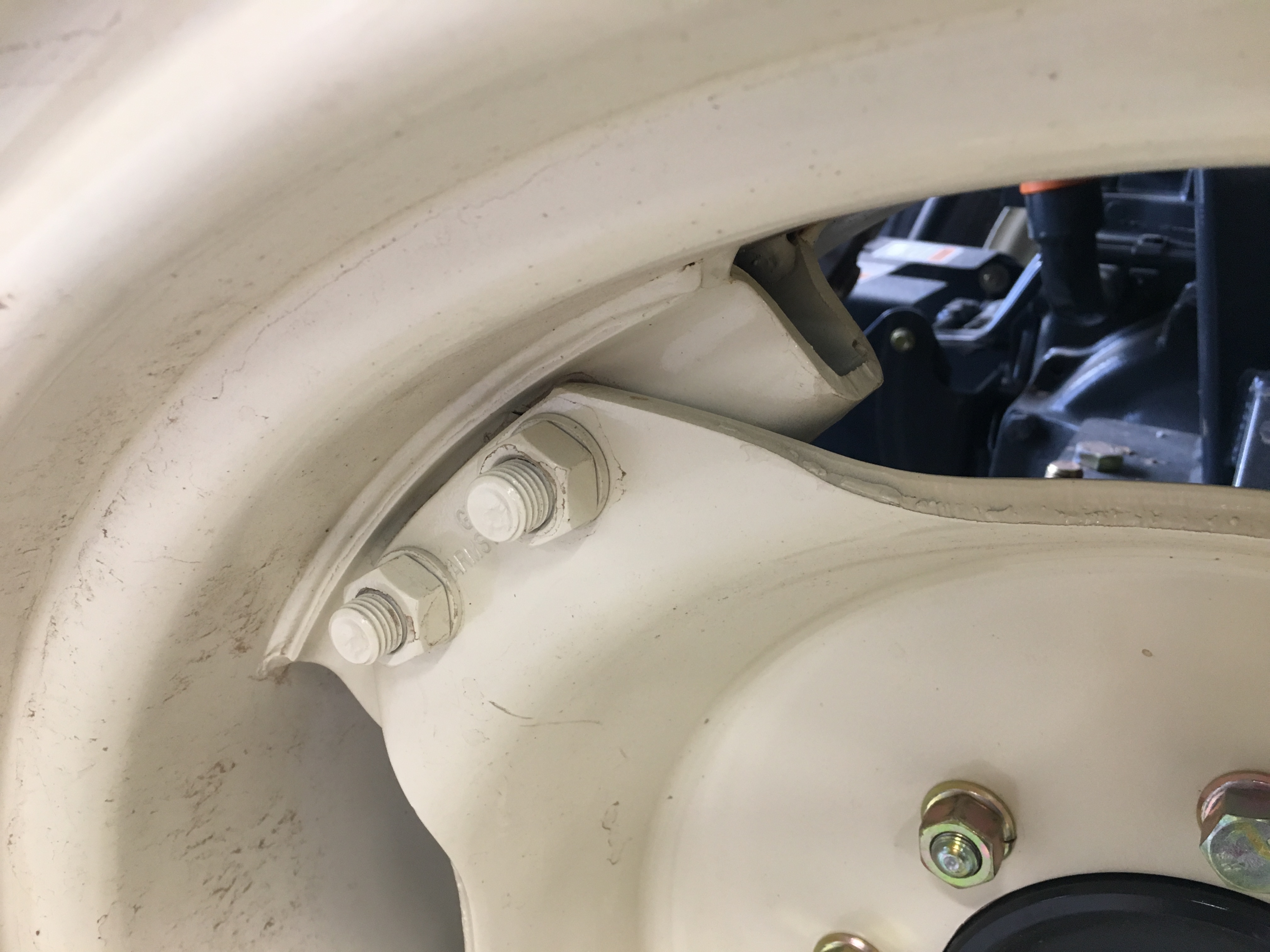

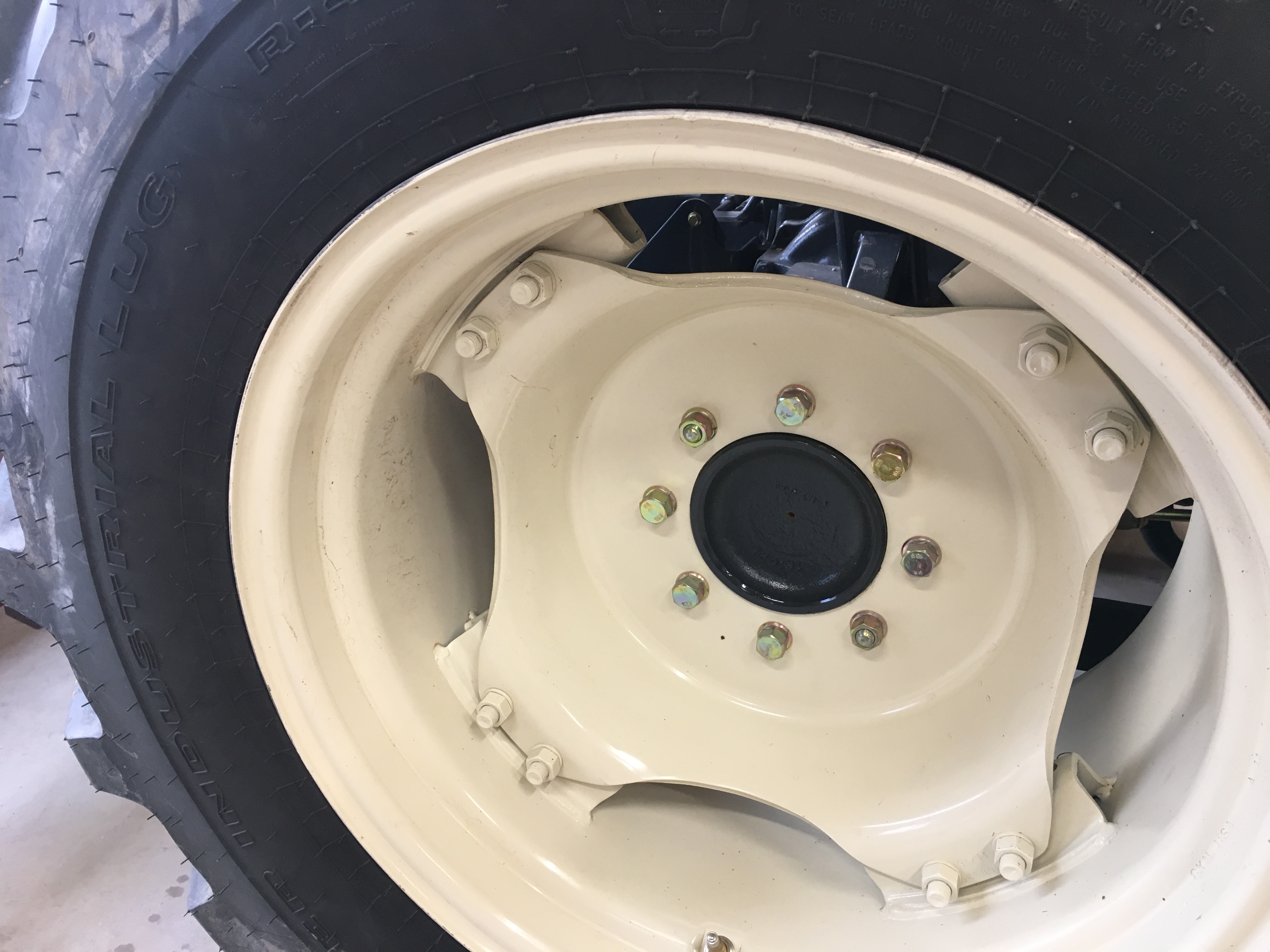

My inner dish is turned to give the most spacing:
I believe all I need to do is unbolt the rim from the dish and move it to the outside inner dish and torque the bolts per the manual.
Am I missing anything? I have everything to chock the front wheels so it will not roll as I lift the rear of the tractor.

You'll need a way to move the rim and tire around without it falling down (it'll be really heavy) and a way to line it up to get the bolts in. Some people here have used a greased sheet of plywood. If I was doing it I'd chain it to the ROPS or something else so it wouldn't fall over.

You should look at the mounting bracket on the wheel, if it's offset closer to one side or the other, you can gain/loose width if you swap tires/wheels side to side as well.
/ Widen rear tread width #4
Yep. Looks offset.
Currently it's offset in plus mounted inside the center. A lot of width to be gained.

Eric, thanks for the idea of using the ROPS to keep the wheel upright.
Richard, yes the dish is pushing outside, the well is inset on the dish. I’ll mice the wheel to be outset on the outset dish. I believe this will give me maximum offset with factory adjustments.

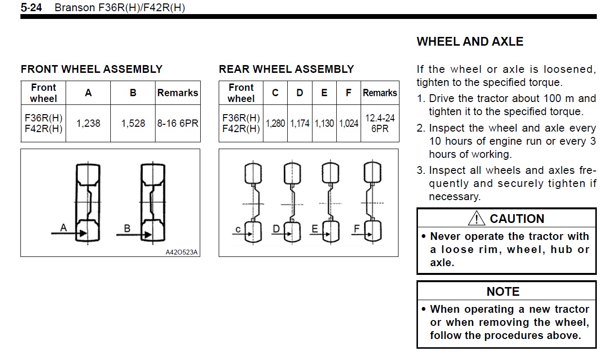

This is from the 15 series. It's odd that they didn't put that info on the 20 series for some reason.

It is odd that it wasn't included in the 20 series manual. You have posted this image before and I referenced it before checking my manual in hopes I would have the same graphic. I also looked at a downloaded manual for the 20 series, it also excluded this graphic.
My rear wheels are currently set to "E", but I will move them to "F" for maximum stability. Thanks for re-posting this graphic.

Not exactly maximum. The diagram shows the tabs in the center of the rim width. As overszd noted, the tab on the outer rim is offset (not in center of rim's width). - Or looks to be anyways. If you move that tire to opposite side (so that tread direction remains correct), then the tire spacing will be maximum width (stability).

To be honest, the diagram they provided can be a bit confusion as they didn't draw the axle so we could have a reference on what is the inside and the outside of the wheel.

I used the arrows on each diagram to show the outside of the wheel.

Yes, but you mentioned you are going to move the wheels to the F position, which according with the dimensions table, it's the narrower position. I think you want the C position.

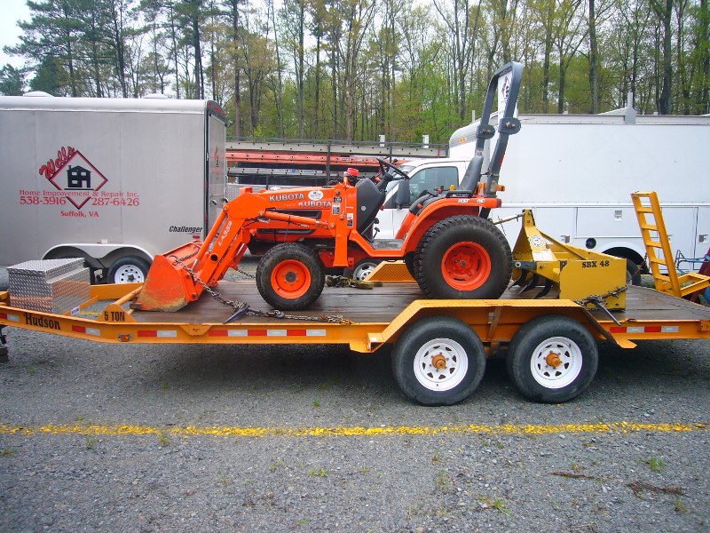

My equipment trailer bought with my B7610:
has the fenders 78" ww to ww.
My M4700, as purchased was 81" wide, so after swapping around it barely squeezed through the fenders
but it fit and balanced.
