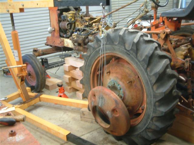

I thought I'd ask this here, since it's not really brand specific. I just bought a 2007 JD 4720 with R4s. I'd like to widen the rear wheels. The wheels have weights and the tires are loaded. It appears I will have to flip the center plate around to increase the width. I have what I need to jack up the rear of the tractor, but I'm wondering is it likely I might mash myself between a falling wheel and the shop floor. Is this I job I can do without any help? The weights are 100 lbs I think. Has anyone done this recently by themselves? And if you did, would you do it again? Thanks

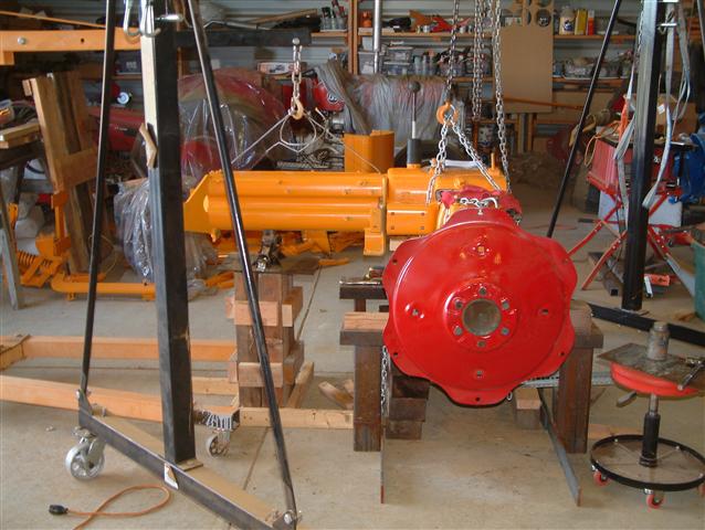

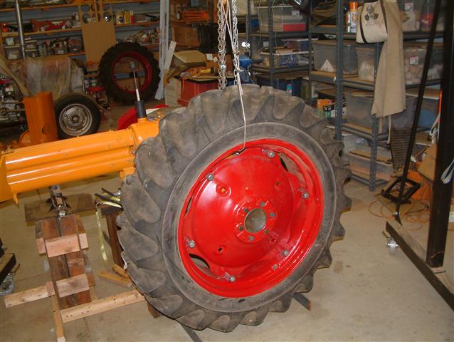

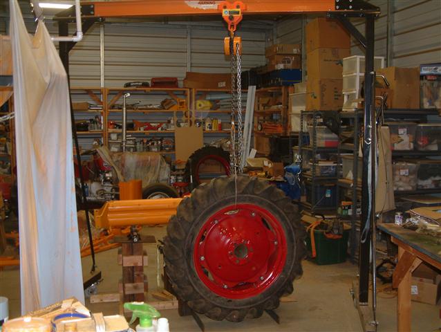

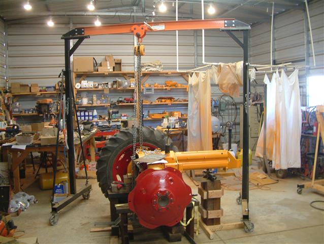

Those rears are probably 13.6 x 28s which are pretty heavy.
I removed and replaced the rears on my 1951 Minneapolis Moline BF by myself. I removed the wheel weights (about 150 lb each)
and used my roll around bridge crane to handle the wheel.
DSCF0002 (Small).JPGDSCF0012 (Small).JPGDSCF0015 (Small).JPGDSCF0017 (Small).JPG
Good luck and be careful:thumbsup:
