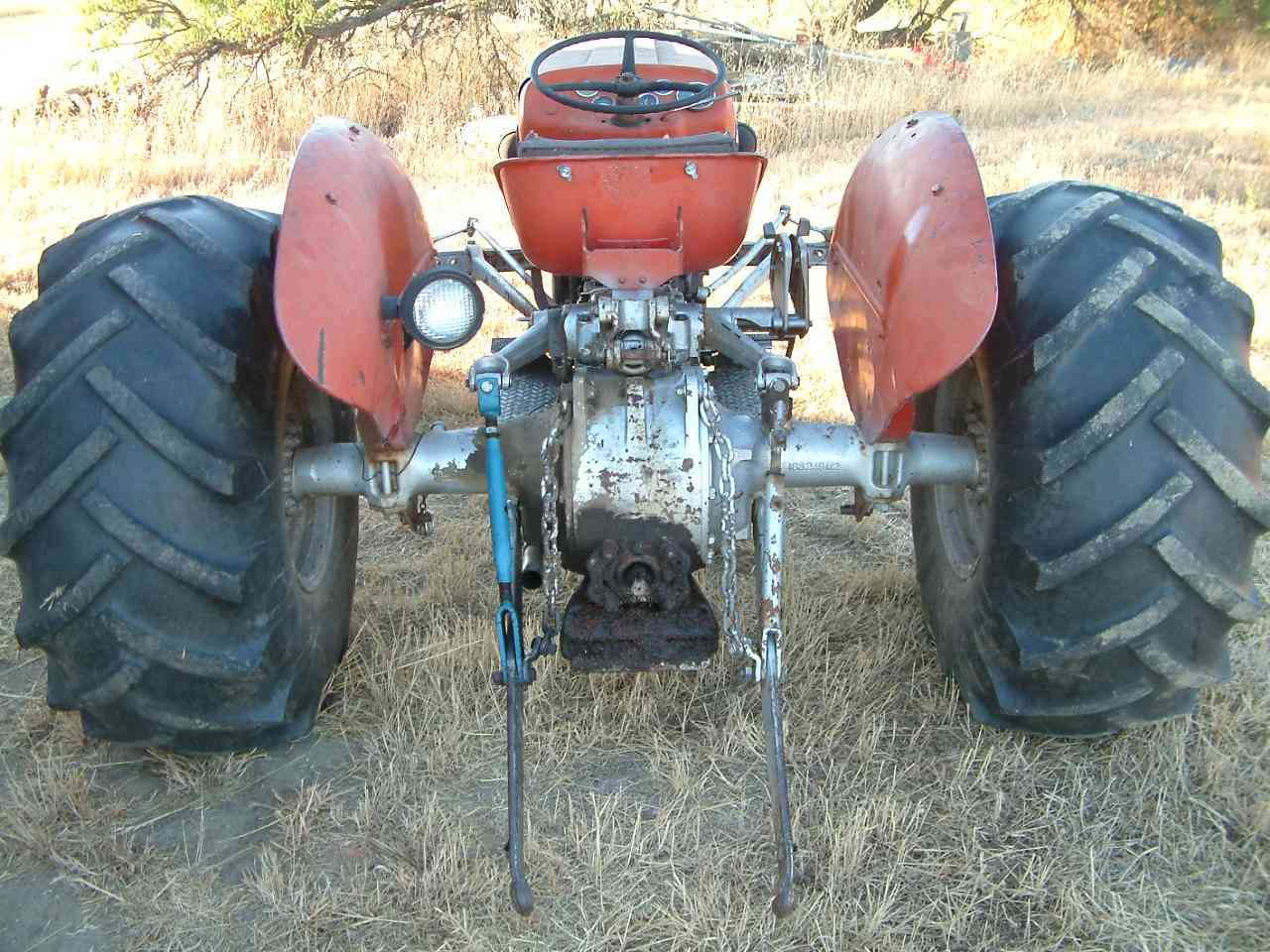

Can you get wider R-1's without changing out the rim? Would love to pressure my dealer if possible. The R1 tires seemed skinnier than other tractors I have looked at, but not sure if it is just and optical illusion.
Carl
Here are the BFGoodrich Silvertown Power Grip 18.4-16A rear tires (on 16" rims) on my MF-135. Are you looking for something like this?
   / Widest (wider) R-1 Tires? #19
That is a very stable looking setup.
Bob
#20
That rules! Would have to change the rims out, and then would worry about stressing the axle on the tractor with that width, but....
