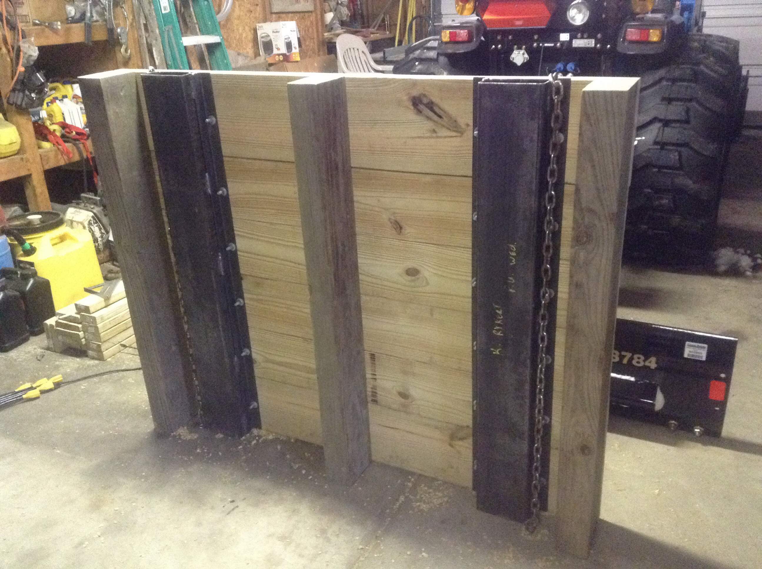

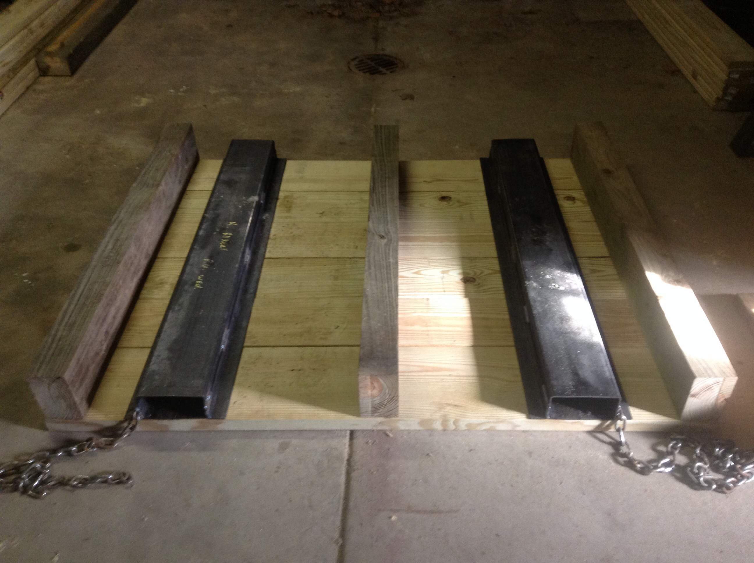

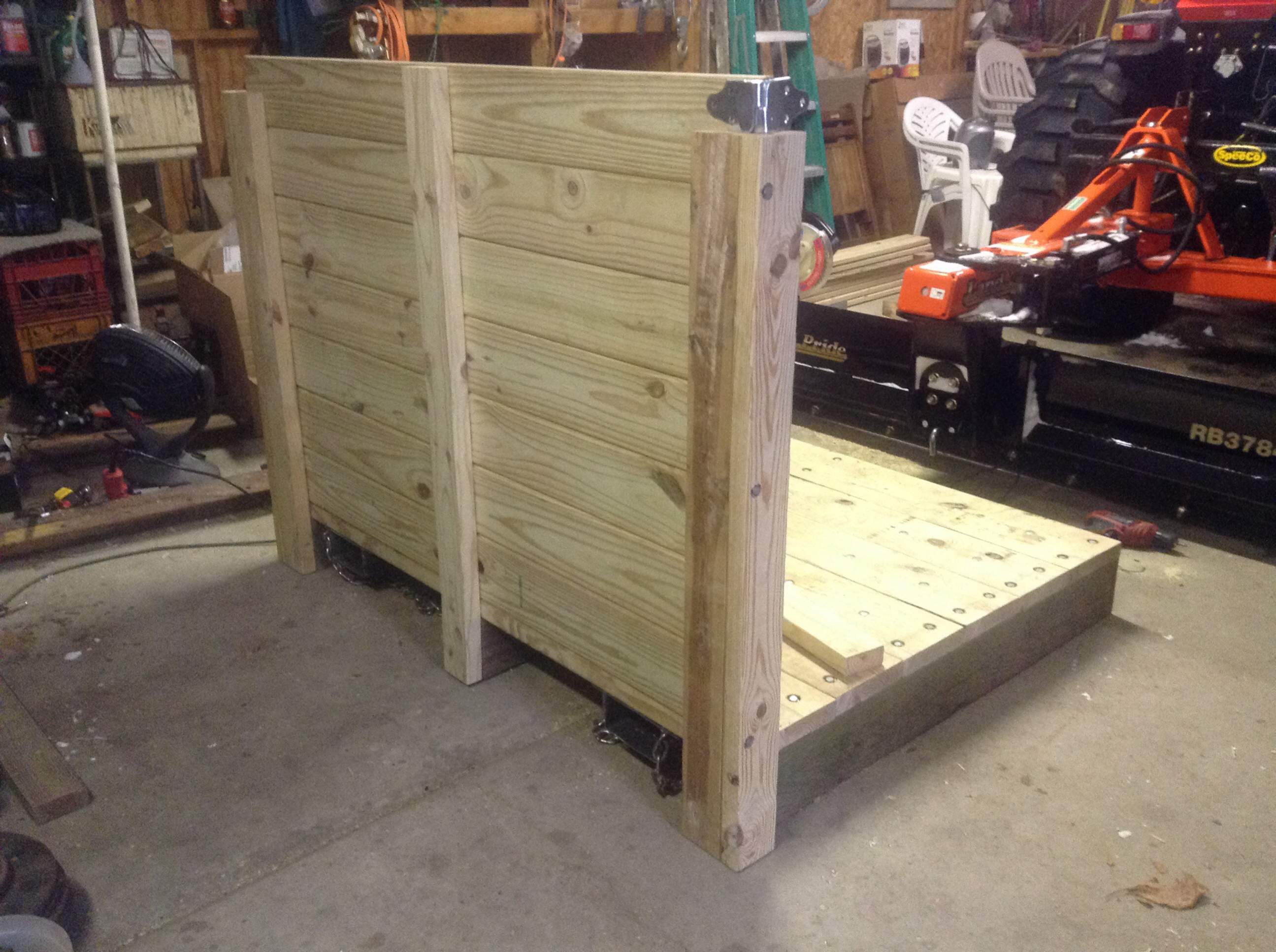

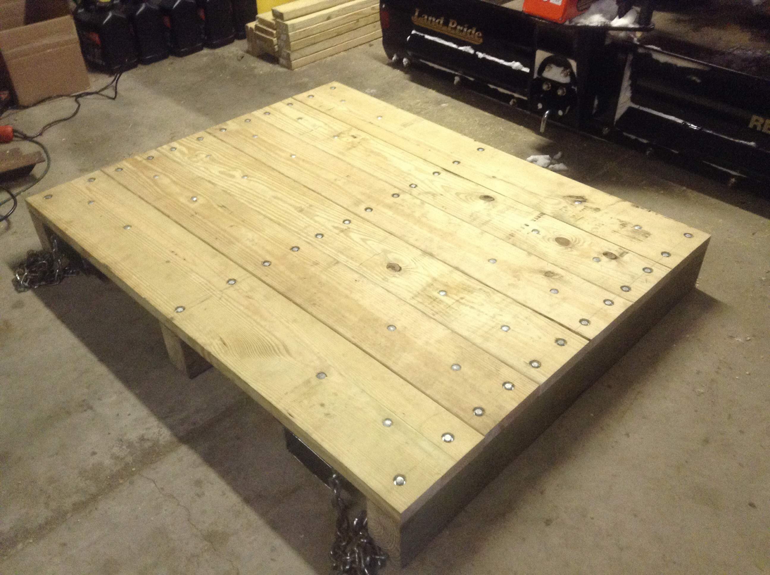

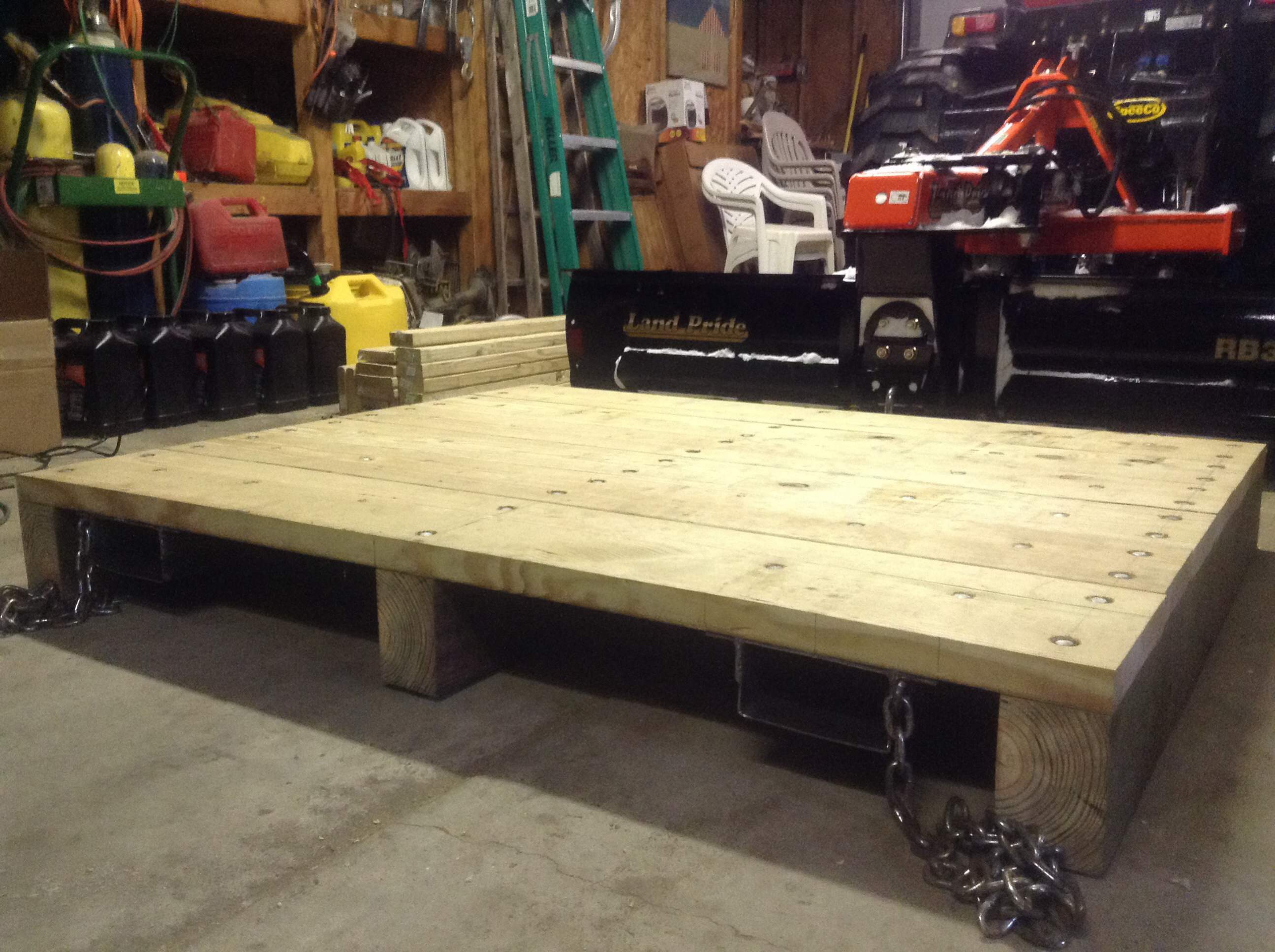

Decided to build a carry-all / lift platform with treated lumber. It is 5' x 4' with 3 removable sides, should be approx. 650# when done (should get lighter when wood dries). Copied some ideas from members here on TBN. I will post more when it's done. No safety police please, I know what I should and shouldn't do wth it!

Interesting, where did you get the metal for the fork channels or did you fab it?
   / Wife lift (Work platform) build
It's 3" x 6" rectangular tube from the steel yard with 1.5" angle welded to it.

Looks good but adding some wood to the bottom similar to a normal wood pallet would be advisable. The wood on the bottom will help with twisting and racking.
I used the box tubing for sleeving the forks on my platform lift a few years ago, works great.
