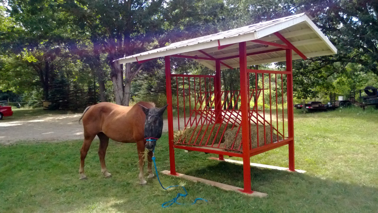

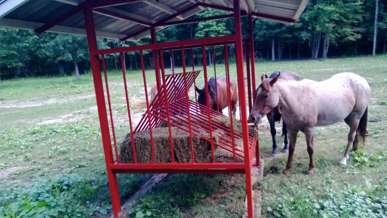

Just so that you folks are aware of the feeder that I'm loading. Opening is good for a 60" x 60" bale. Vet likes that fact that the hay is off the ground to lessen the chance of sand colic. I designed and built it last summer after seeing one from Klene Pipe on video.

Nice looking setup.

My next one is going to be a 5045 or 5055, gonna keep my 790 though. I do the same thing, trick I learned is you can curl more than you can lift, I roll the bale spear forward a little, lift the bale, then curl it back. It will gain you another foot or so on the front of the bale, at least it does for me. The other thing I have is a forklift mast that hooks into the backhoe sub frame, I can lift 1500 lbs. on the rear with no troubles at all. Cant dump or reach but it works well when its on the tractor. I just lift the bales between the forks and set them into the feeder. Trouble with that is I don't keep it mounted on the tractor most of the time. By the way I love your feeder, nice design and looks well built.

Wow... nice feeder. Any pix of it with a round bale in it? Great for horses... off the ground and covered. How meny horses do you feed with it? Looks like the sides fold down as the hay gets eaten, so they can get to all of it? We do our own squre bales, and with only 1 horse and 3 ponies its not too hard to keep up with. If we had more, and fed in the field I would steal your design in a heartbeat!

Nice job on the feeder.
