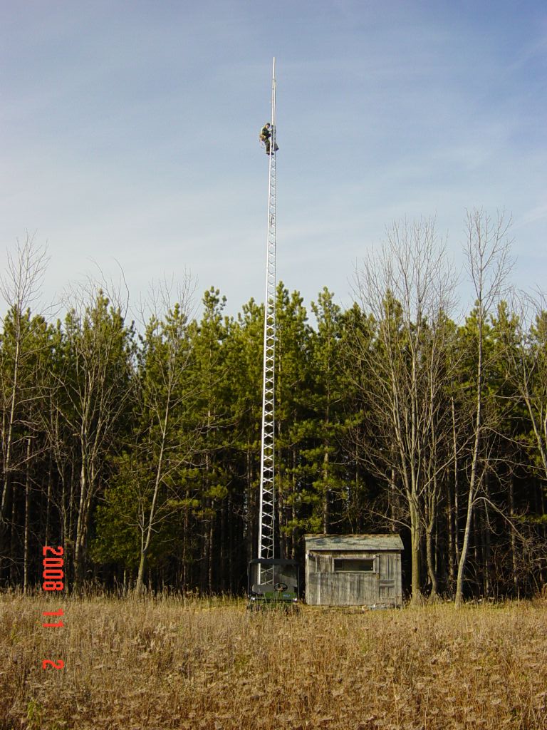

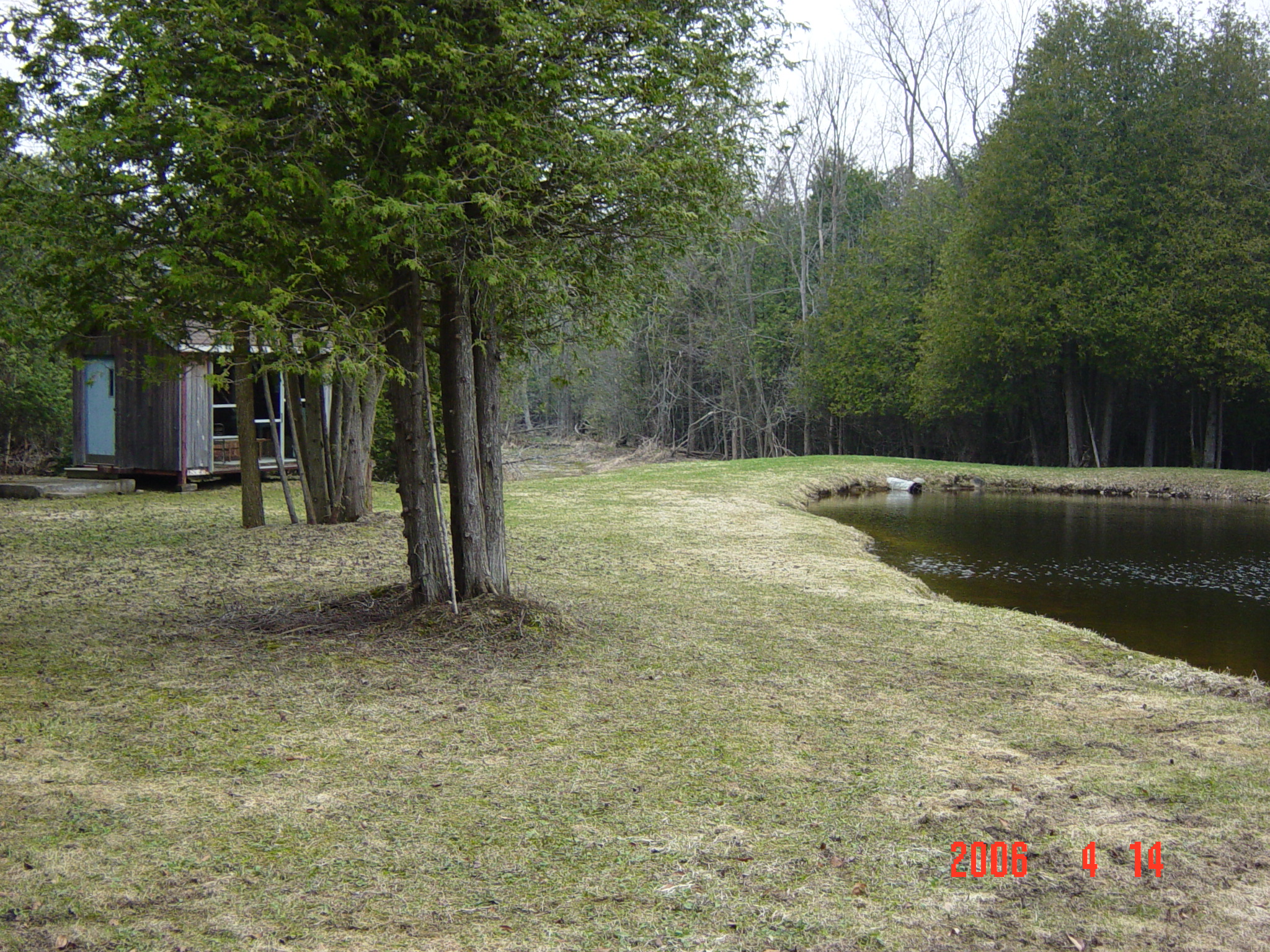

I would like that property wide WIFI. But it's also this. I just had new Internet installed today. They may be interested in my tower. The installer said, if they put an access point on the tower, they may knock off five bucks a month. Excuse me? Did I hear right? At ten new customers, you get free Internet. So (always thinking ahead) before the ten is reached, I thought maybe to ask them for something else, if it's possible. So I am researching what the technical possibilities are. As far as bandwidth, I wouldn't be using any more at the shack than I use at the house. I would even agree to pay for some of the hardware.
   / WIFI Personal Hot Spot. What are the Limitations? #12
I take it you get wireless internet access to your place via an antenna that's up on an 80' tower?
A wire comes down the tower from that antenna and goes to your house?
You want to be able to have internet access at your shack about 2500' away from the tower?
And you want to have internet access all over your 100 acres?
Is that correct?
Do you have good cell service at your place?
#13
That is correct. The Eithernet gets converted to 500 feet RG6 coax (3GHZ bandwidth) back to the house and to Eithernet again. Yes, I have a new BELL Cell tower within eyesight. I am on it with my phone.
#14
Not that it helps the technical issues. But I like pictures and some context is always good.
Tower, and what my Lady friend calls "the Chicken Snack Shack" No idea why.
