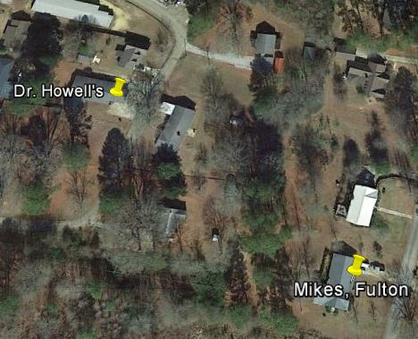

I second that. My BIL has a similar situation in town.
Going from pin to pin (his office to his house)
it's about 150 yards with some vegetation.
He's been running it for about 5 years, basically using his practice's internet for ALL his internet.
