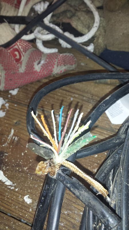

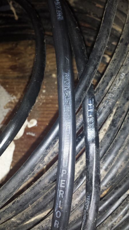

Yes...I'm wanting the cheapest route....that works.
It's not cat5 cable. Here's a better look. Will it work? Gunny I like your little thingy from home depot.

If it's not cat5 then I'd be dubious. Are the pairs twisted at all? If not then there's a good chance to cross-talk and other stuff that'll hurt the effective range.
   / Wifi to barn #28
So grab a couple screw or punch to rj45 boxes and try it. You'll be out 10 bucks if it doesn't work. If the are not twisted pairs it doesn't bode well but I'd try before spending $100 on other solutions but I'm a cheapskate.

Not twisted.
I'll piece something together as a try, but got fading hopes now.
