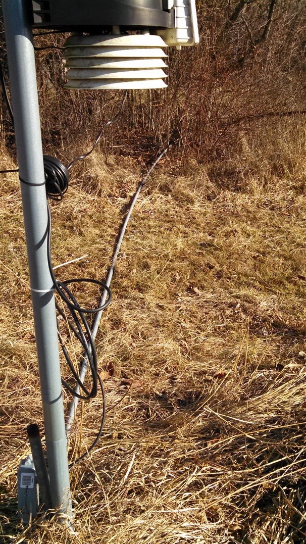

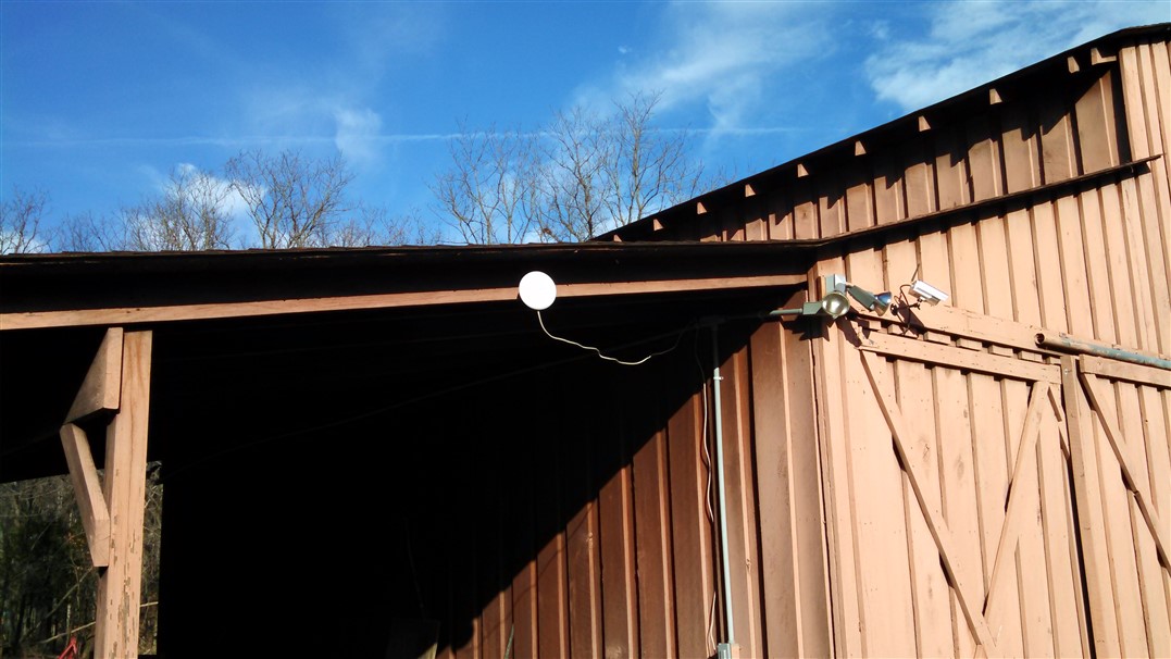

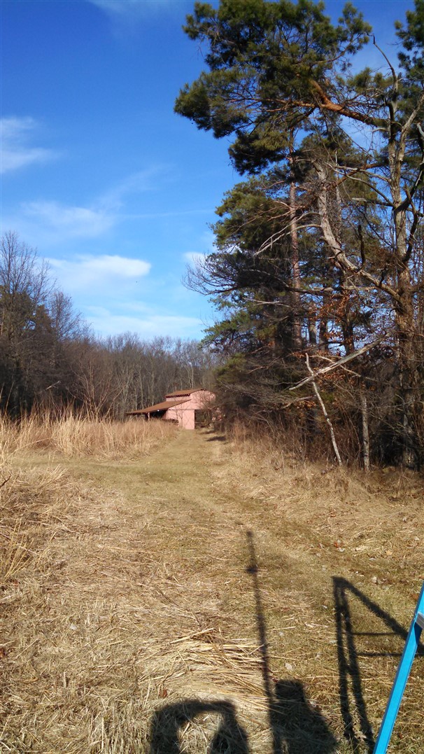

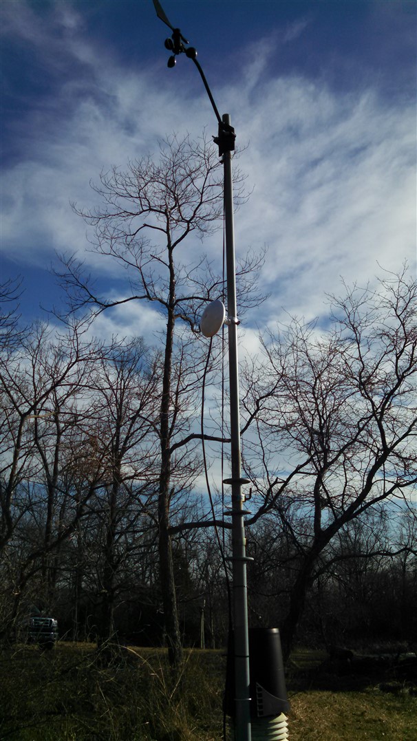

Spent the day installing a Ubiquiti Nanobeam M5 wireless bridge to the barn. Simple with the instructions from the Ubiquiti site. It was the warmest day in some time, but the ground is rock solid. So I've left the conduit on the surface until spring. I'll bury it and clean up the wiring at the barn. I did a speed test from the barn and had the same results as in the house.
The radios are only abut 10' off the ground. Don't think I need to go higher for this flat, clear line of sight. I'll wait until some nicer weather to attack the pump house. Happy for now. Thanks for the guidence.
