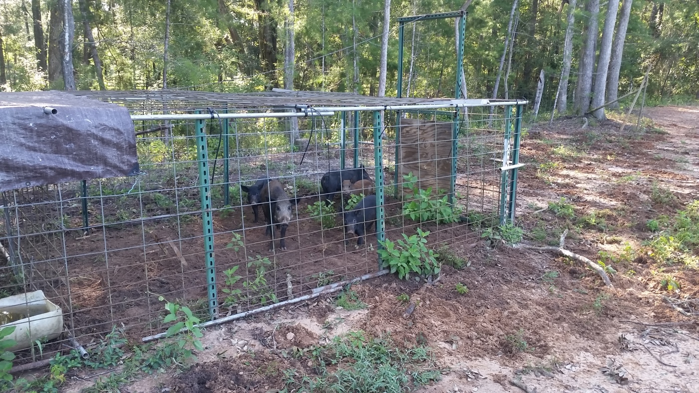

I just finished putting a trap like the figure-c trap. The hogs did not find it last night, one raccoon did. I have the trap open till the hogs start using it. Should be soon as they find the corn usually right after I put it out in front of my trail cam.
How to Build a Figure-C Feral Hog Trap - YouTube
I would try to shot them but they are there mostly night and no special time.
I will let you know how it works.

If you are feeding anything with corn they will find it. My bout with them was because a neighbor had a deer feeder spewing corn out twice a day right below my property. I had a friend that traps them bring a homemade trap out and we captured a few but when the feeder stopped operating they moved on.
His trap was just some hog panels tie wrapped together with a hog panel on top. He had a couple pieces of narrow channel for the plywood gate. Just ran a rope off the top of the gate to the rear of the trap with a stick tied onto it. Drove a couple of stakes in the ground with screws to hook the stick on. Hogs would trip it rooting around in the corn.

Nice job ! warm up the smoker...
