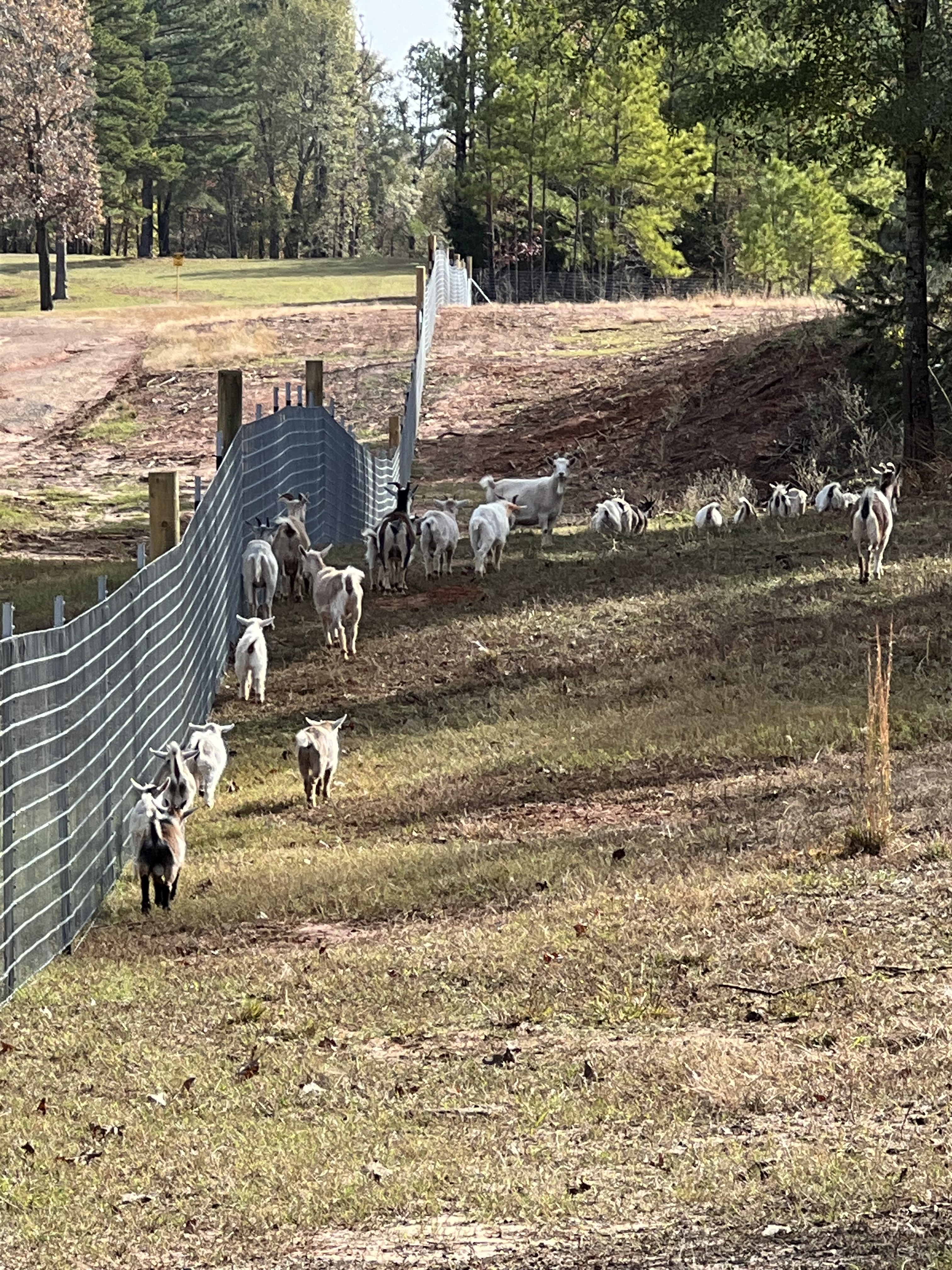

Goats sell for around $100 to 150for adults here, for just meat goats. Kid can be half or less.
Not Registered or fancy. Milk goats tend about 200+
If you time it right, you can get em free when someone is pissed at them.

I believe that @ultrarunner is in an area with both high demand, and lots of local requirements. I suspect all of which add to the cost, plus most of the larger goat herds come from several hundred miles away. I know of one Texas operation that brings multiple million dollar herds out here for fuel reduction.
I wonder how far away your Arizona herds have to travel.
All the best,
Peter
IDK where the AZ goat herds come from. There are some local ranchers there that do the fuels reduction herding. There are also some that come from Texas and adjoining states.

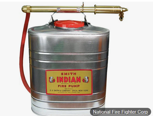

Also,maybe consider a nozzle that can also shoot out a narrow stream of water so you don't go through all your water quickly. It's amazing how much fire one of these could put out with a small stream of water..
2707551
Grandpa filled his with Diesel. Better to make the fires burn.
