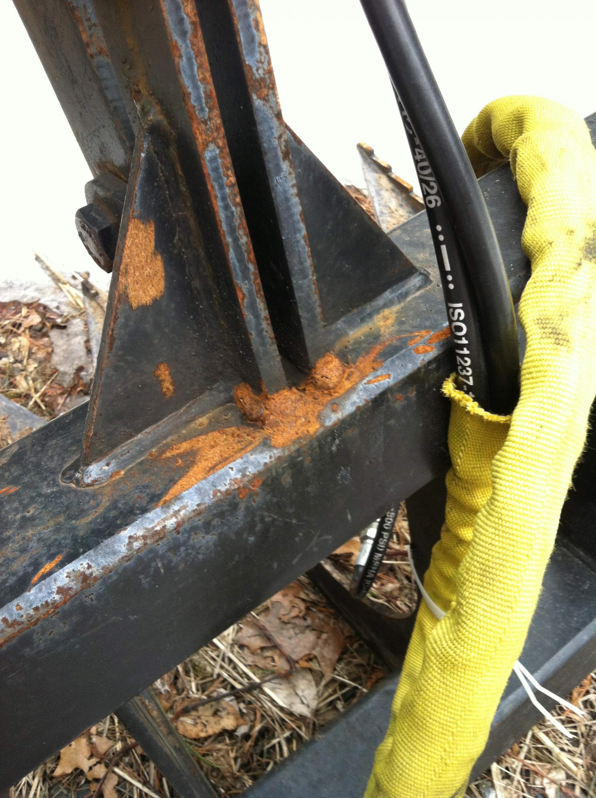

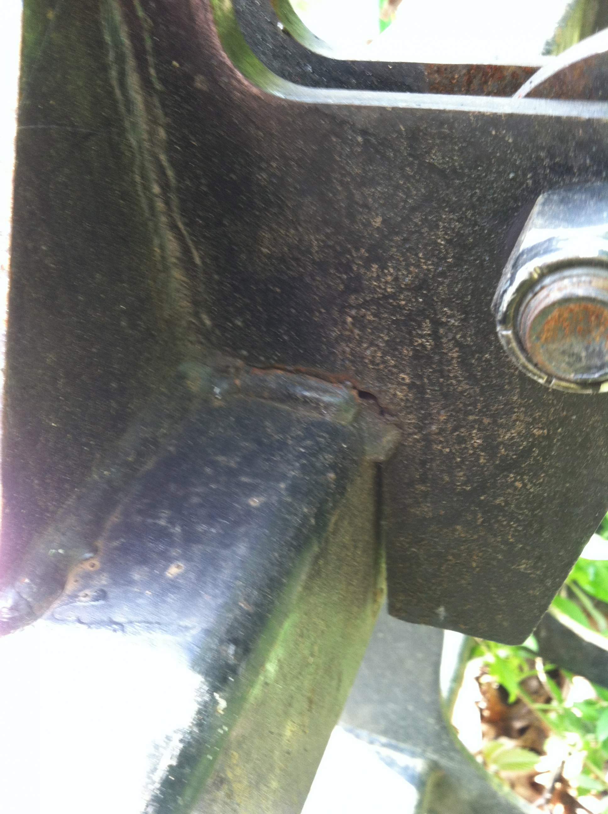

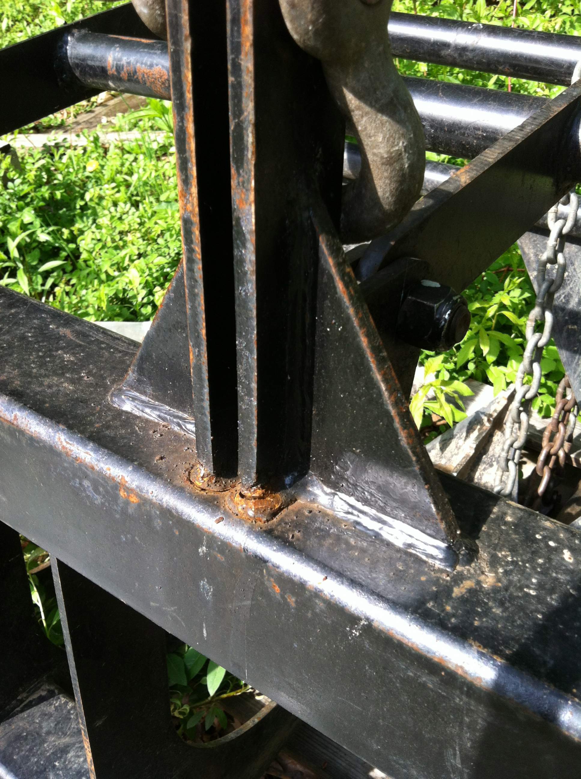

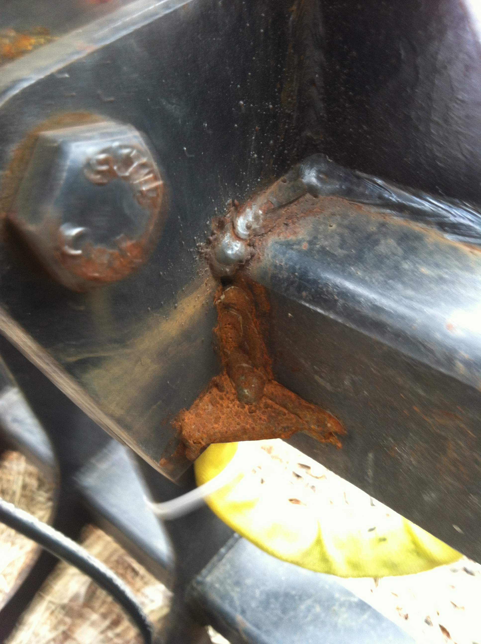

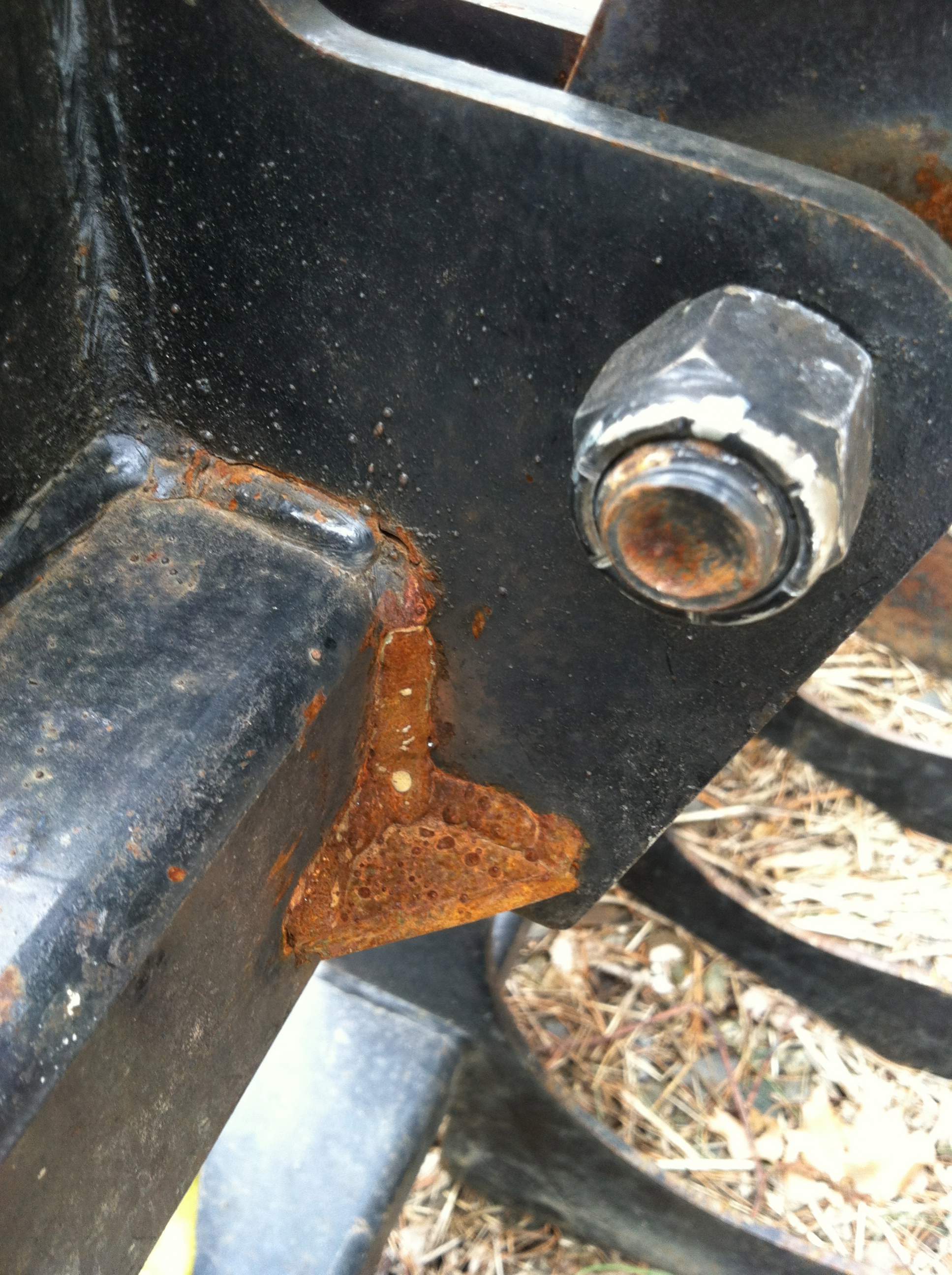

MoPioneer- that you were and one who influenced me to buy mine. As I have said in this thread-great value-attached are some pix of the damage I inflicted through what was a plain dumb *** move on my part. couple of pieces of 1/4" plate, good as new!
   / WildKat 48" Econo Grapple
#23
View attachment 443710View attachment 443711View attachment 443712View attachment 443713View attachment 443714
I think mine is made different. The bottom of cylinder hinge support is welded all the way to the rear of the
square tubing it sits on.
