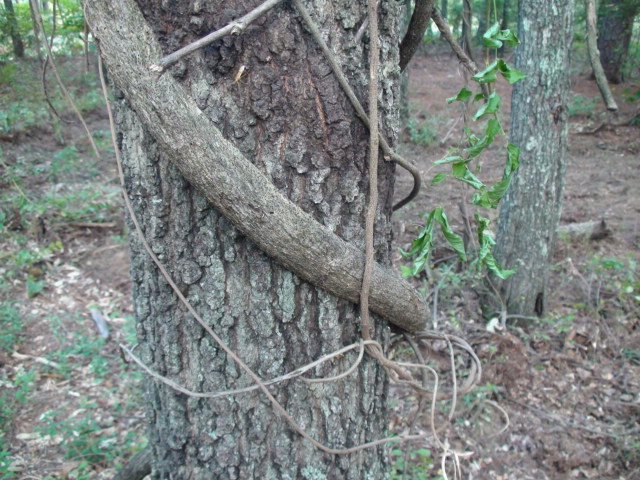

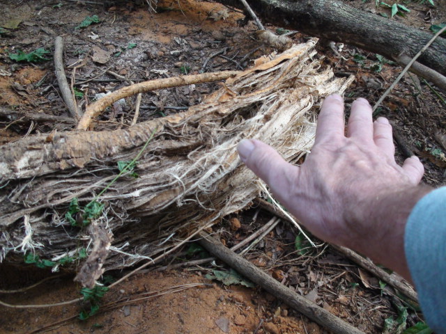

Oh it certainly seems sturdy enough to do that but I have not tried it yet. I think the larger question would be does the tractor have enough traction/weight to do this? I was using the BB to uproot some very large parasitic vines and had the rock grapple on the tractor using it to clean up some large, dead branches as I moved around the property. I was coming up an access lane about 3 MPH or so and the tractor was rocking forward and backward a little bit as I was traveling. I hit a rougher spot, did not have the bucket high enough and it dug a couple of inches into my hard packed clay; the tractor did not slow down a bit and the bucket probably only had a bit more of its paint scratched. I attribute this to the very strong teeth and their ability to fracture the soil ahead of the cutting bar.
Some of the vines:

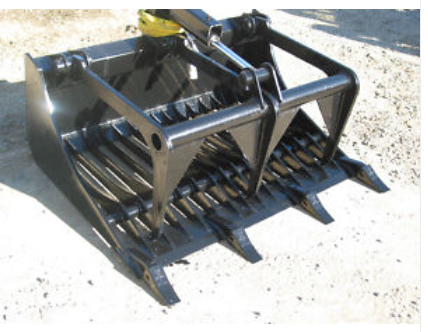

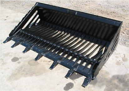

Attached are the CID stump digging bucket, a general 72" rock bucket and the 48" rock grapple bucket. There are less expensive stump buckets than this one, as I have found them for as little as $495 + shipping. The grapple on the narrower 48" bucket was a bonus for me and the cost was similar to the larger bucket with no grapple. So win-win in my book. Another consideration with a rock or root bucket is the amount of steel used to build one is much greater and consequently heavier than a standard type of bucket. A 66" - 72" rock or root bucket will weigh several hundred more pounds than a 48" bucket, which detracts from the FEL overall ability to lift more weight, outside of the attached buckets, and for my uses, a larger bucket is a liability in all realms of cost and performance.
