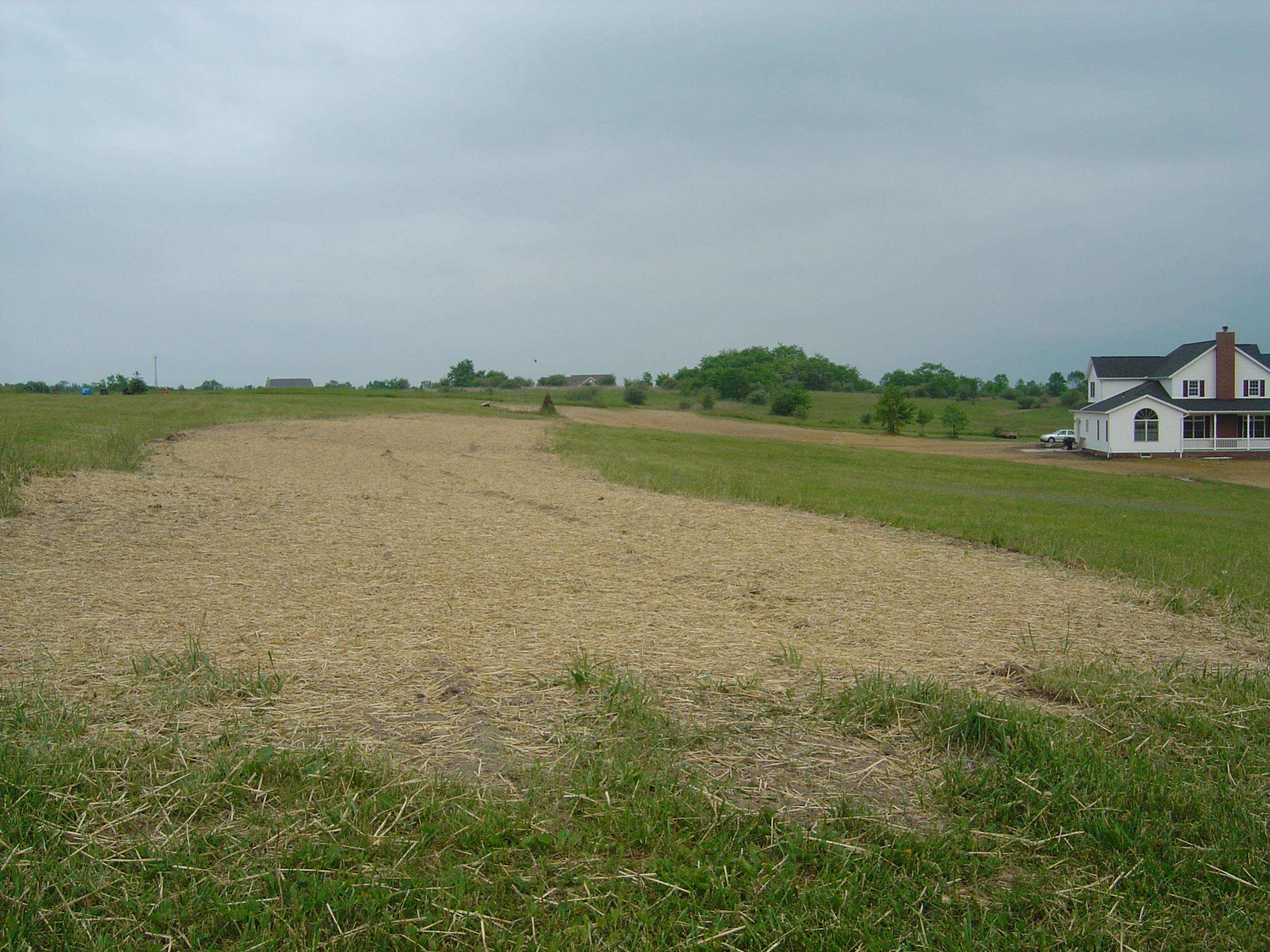

I own acreage of reclaimed strip land, where I built my house. I used a subsoiler/middlebuster combo from TSC (~ $120) to loosen up the soil where I needed to work the ground. I then plowed with a single bottom plow (my tractor is a 24 horse New Holland; I can't pull much more than that on this type of ground), disced, and smoothed with a box blade (where I was planting grass).
If you are planting food plots, I think the subsoiler/middlebuster would come in handy the first time you are turning the ground, then in subsequent years the plow would be enough. I have used the scarifers on my box blade to break up the ground as well, but I like the middlebuster a bit better as it seems to penetrate a little deeper.
The latest project I did with this setup was this past summer. In the attached picture, the long narrow section covered in straw (up to the small pine in the center of the picture), is about 100 yards long, and it was covered in ruts from trucks. So deep, in fact, I found an axle when I was plowing! Anyway, I was able to bust, plow, disc, and smooth in a morning's worth of work with my small setup.
I bought my single bottom plow at auction for $125. It's been money well spent. The disc is a hand-me-down.
I had good success planting clover when I first purchased the land, and the deer seemed to enjoy it.
Best of luck to you, it is an enjoyable process. Enjoy your new toy, I know I have since I bought my land!
