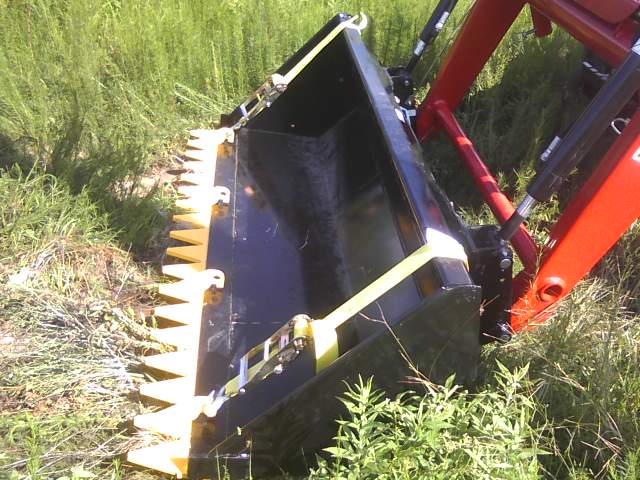

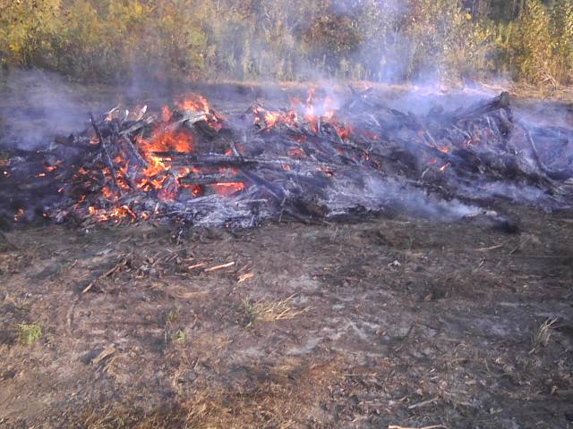

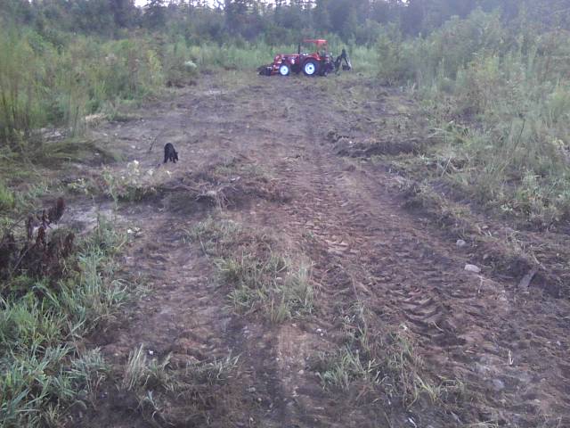

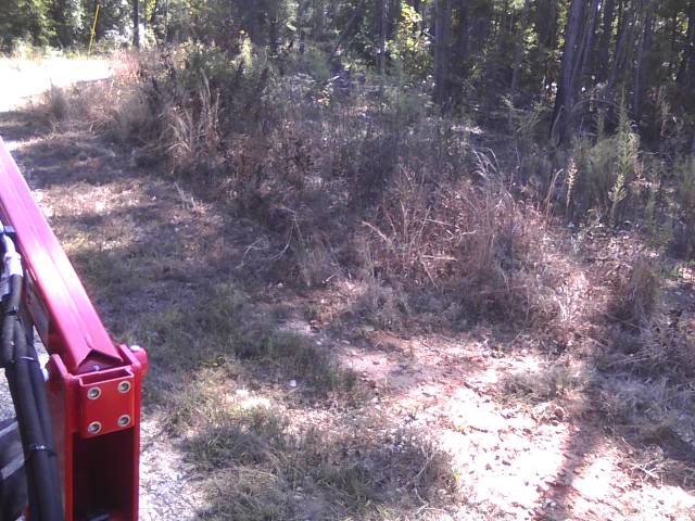

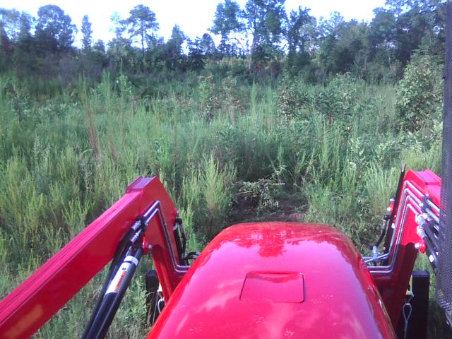

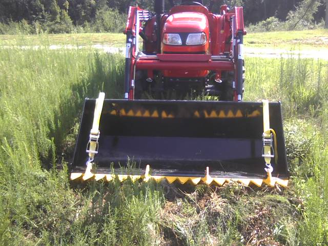

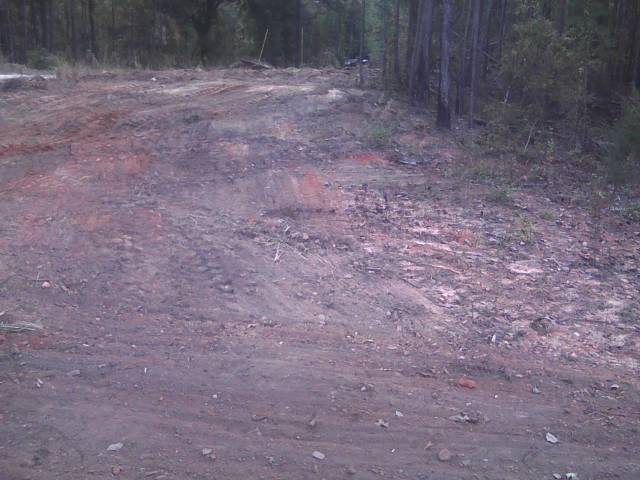

jodebg I have a 72" RR for 72" FEL and love it. I used mine to clear out saplings where I wanted to make me a burn site and it took me no time. I have only made one pass on parts for the driveway just to check it out and the wife said it did make a difference. It takes no time to hookup or take off but I hear some use the straps to attach or go with chains and binders. But as far as fitting for your tractor it most likely need to be cut and this tool is no way can be used for digging.In one photo you can see there are extra holes to mount a hook to secure the tool that I don't use. Here is a few photo's when I made my burn pile and cleared what loggers left for a mess.
