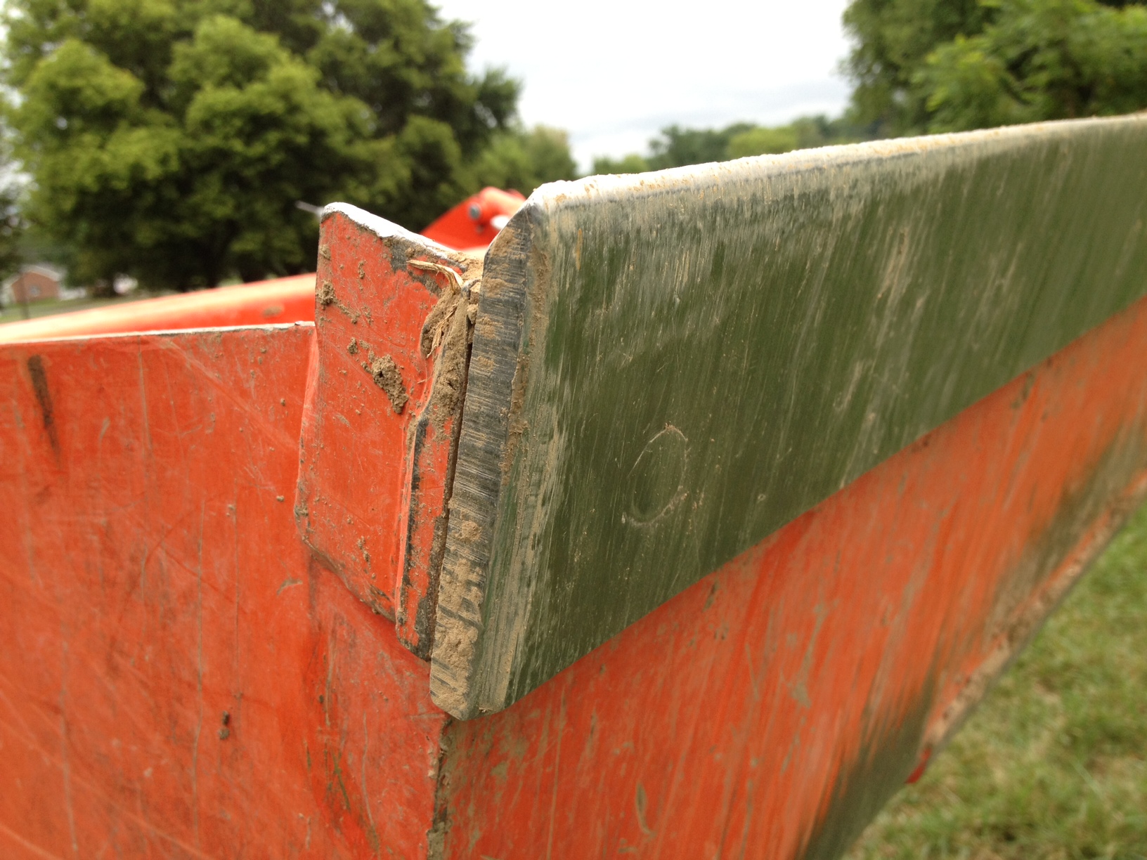

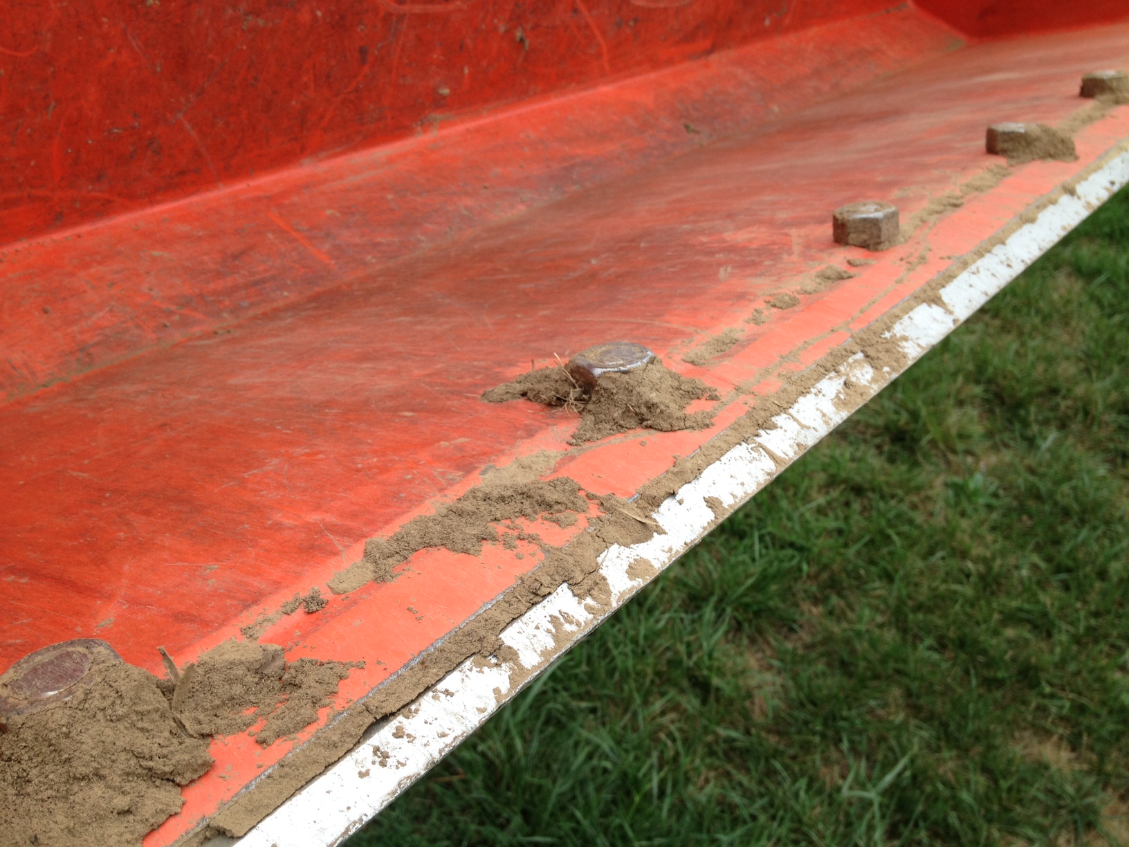

I wouldn't be without an add-on wear edge. The first year of plowing with the B7500 wore the bucket edge quite noticeably. Added a wear edge and no further damage for the following 9 years.
It's one of the first things I did to the L3200. The bar is heavy stainless with 1/2" stainless studs plug welded into it. The bottom is ground smooth and nuts inside the loader keep it in place.

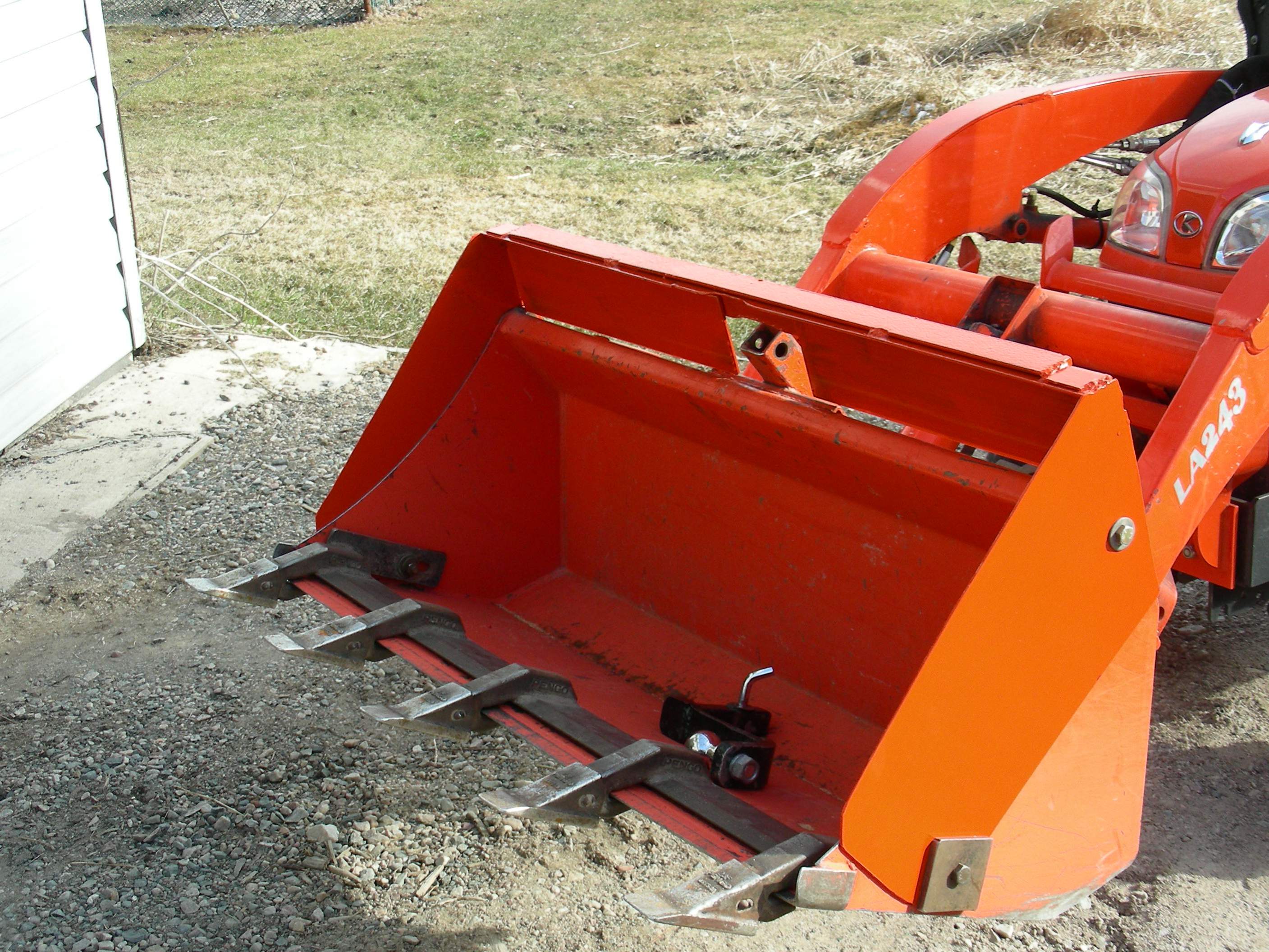

I use my BX2660 with normal bucket for snow removal (besides my rear Snowblower) BUT I keep my toothbarclose by all winter because of two reasons.
1) when you are moving snow banks (so many full buckets of snow from point A to point B ) the five minutes it takes to add the tooth bar, allows the bucket to hold that extra 8 inches of snow and so somewhat bigger volume of snow.
2) When the drive way or unpaved sections get too much ice buildup the toohbar when dragged backwards at an angle will score the ice and maybe even break it up, just be carefull how much down force you use not to bend bucket cylinder arms.

Hi folks, just another experience that may be useful,
We have a B7800 and bucket with a Piranha tooth bar, an asphalt lane and have not had problems using the bucket in snow and ice. Just be careful of the angle of the bucket and place the tooth bar parallel to the pavement. It cuts through the packed snow easily. We back drag the tooth bar, using the bucket float to scrape through any ice (and freezing rain before the snow is common here) , and the sun on the bare pavement sets up the melting we need. It doesn't seem to tear up the asphalt coating.
