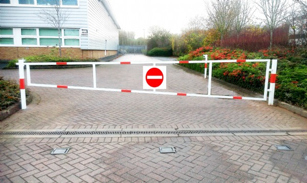

I've decided what Im going to do. Rather than a cable gate, which would have me worrying about the livestock, I'm going to weld up a swinging gate similar to the one pictured. Although it will require a very substantial post at the hinge side, I can place that post anywhere I want (within reason) and avoid the buried power and fiber optic lines on either side of the road, this because I can choose any length for the gate I want because I am building it and am not stuck with standard sizes
One modification I am going to make to the design pictured is to simplify the hinges. Rather than using hinges at all, I will use a steel ground post slightly smaller in O.D. than the I.D. of the hinge post on the gate, and slip the gate assembly down over the ground post, setting it's height with a grade 8 bolt through the gate hinge post and riding on top of the ground post. Since this gate will only be used about 50 times a year, I think it should last decades, and the massive leverage it will provide upon being swung will render any resistance that corrosion in the hinge causes trivial. Come to think of it, I'll have a place to pour my used oil.
