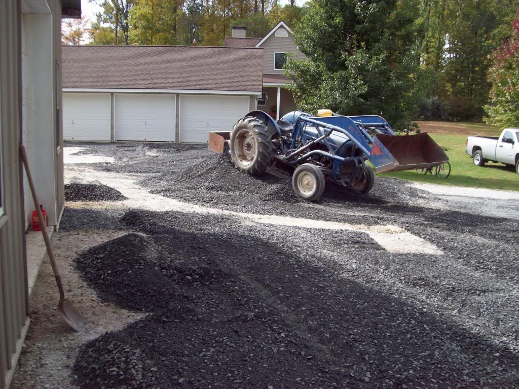

My United Box Blade is the attachment I use most often with my old 1958 861D Ford. A couple years before this picture was taken, I leveled about 10 dump truck loads of dirt to fill in where an old church once stood with that box blade and a little 8N Ford tractor that I had then, which is allot smaller than a Ford 4000. The little 8N did not have wheel weights either and only 1 tire was filled as I had just repaired a flat and replaced the inner tube in one rear tire and never filled it back up.

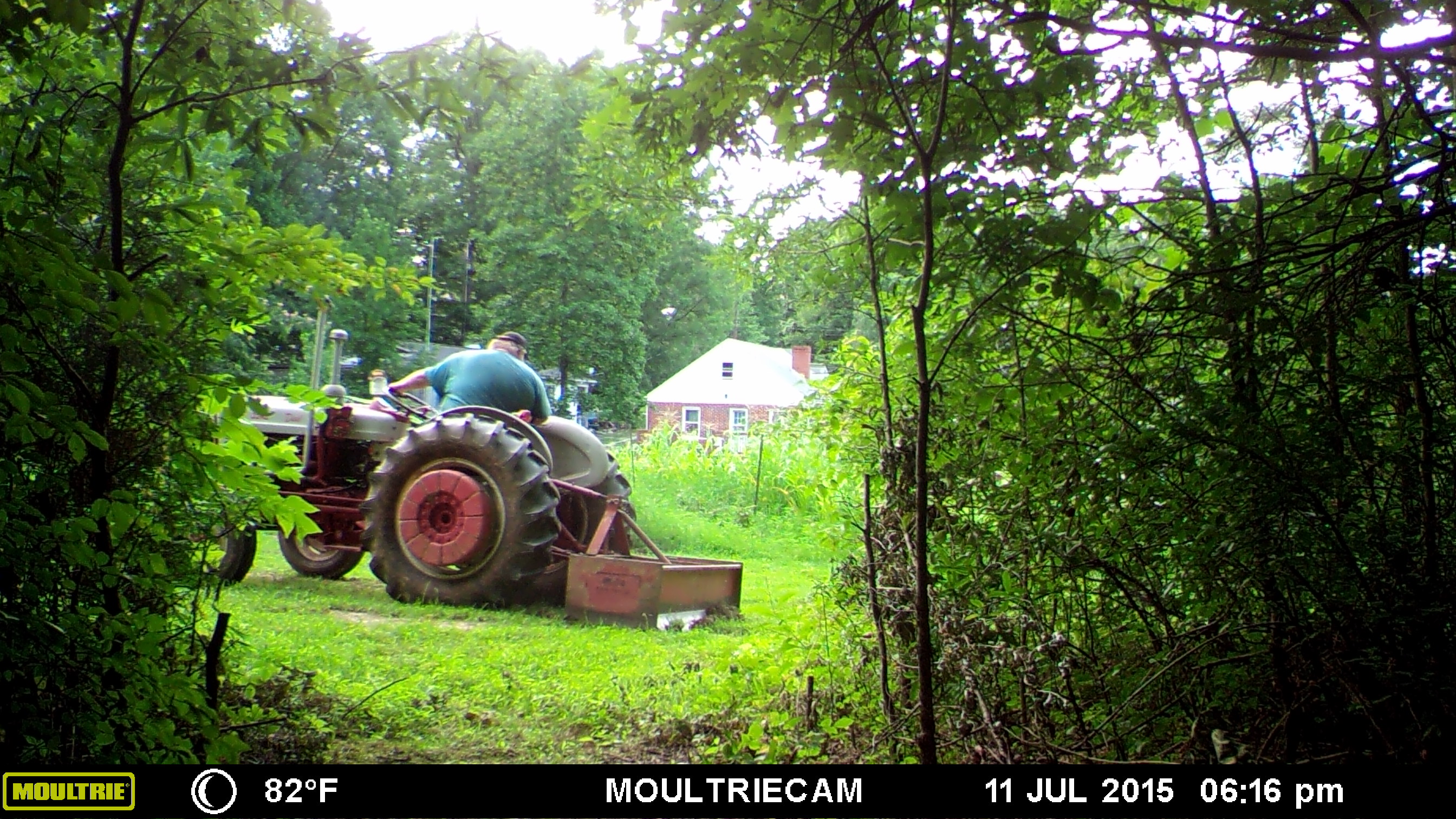

Even my 640 with less HP than your 4000 has no trouble pulling a 5' box loaded with dirt or gravel. Scarifiers will help in new ground.
Kirk
