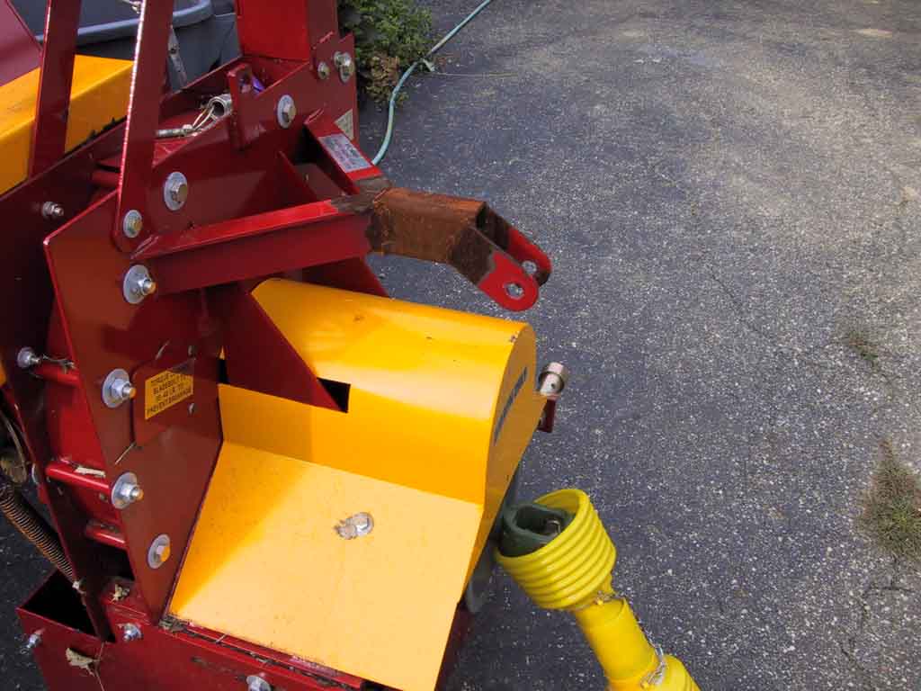

rswyan,
how did you modify the chipper for your speeco hitch, i am in the proccess of trying to adapt all my 3pt attachments to the speeco. a photo or description would help get me started in the right direction. glenn
   / Will A Jinma Chipper Fill A Country Mfg Wagon? #10
</font><font color="blue" class="small">( how did you modify the chipper for your speeco hitch )</font>
Cut off the ears for the toplink bracket, weld in a piece of 3" x 2" 1/4" wall tube, weld the ears back on at an angle to lower them to the height I have my Quick Hitch top hook set at. See attached.
I have a hydraulic toplink on my B2910 - in order to hook up the chipper I must retract it all the way, engage the lowerlink hooks on the chipper's lower pins by lifting them, and then extend the toplink so the the hook on the Quick Hitch is lined up with the pin hole on the chipper toplink bracket, then insert the toplink pin/bushings. This procedure is neccessary because even with lowering the toplink bracket on the chipper (so that it meets the upper most position possible on the toplink hook on the Speeco) there is not enough clearance to lower the toplink link to get under the toplink pin on the chipper if it is instaled on the chipper, due to the pulley guard on the chipper. It's not 100% Quick Hitchable - but for me the hardest part of attaching 3PH implements are the lowerlinks anyways.
</font><font color="blue" class="small">( i am in the proccess of trying to adapt all my 3pt attachments to the speeco )</font>
Make sure that you check all your implements for their top pin heights - it will take a little figuring to determine which position of the top hook will be the best given the implements you have - for me it was having the top hook in the uppermost position.
