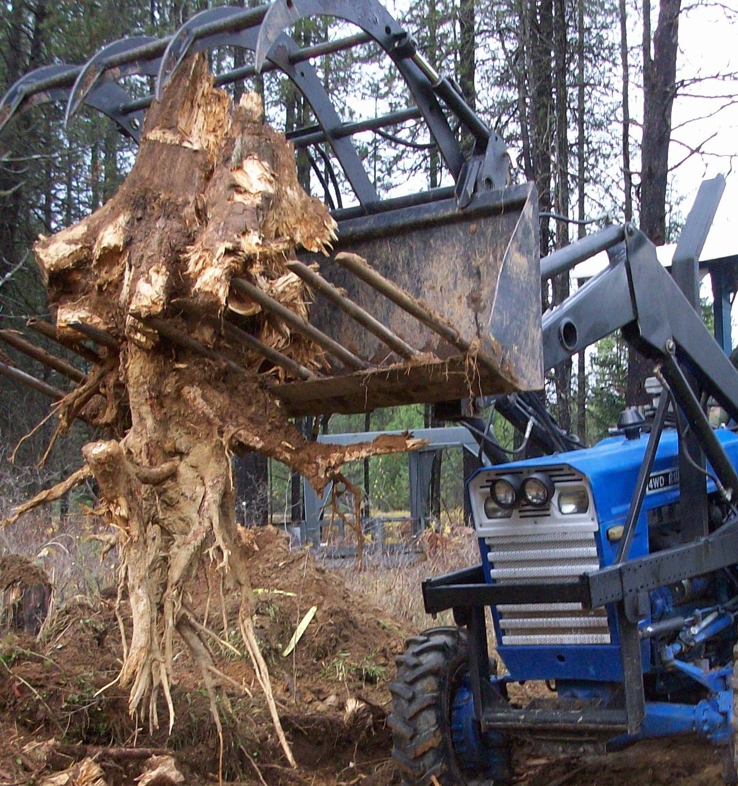

It was the left lift/boom cylinder. I did not have the loader at the lowest height with cylinder rods bottomed.
Was digging with the regular bucket angled down 1st gear weighted wheels and 1100lb on the 3 point lots of traction. I have also blown out a grapple lid hose one time trying to pull a stump over.
Those are a couple reasons I finally bought an old industrial TLB.
On most CUT's when the valves are centered and the cylinders are anywhere but against stops, this pressure spike in a line and against the piston seals can happen when push comes to shove.
ps. the hoses were originals so at least 20 years of use already.
Including digging my first stump out with the grapple early on, along with destroying a chain on my saw cutting some side roots but in the end the tractor did win the battle.
Back then a stump bucket would have been a Much better tool to have than a grapple. but I used what I had.
Them Tap roots can make things interesting.
