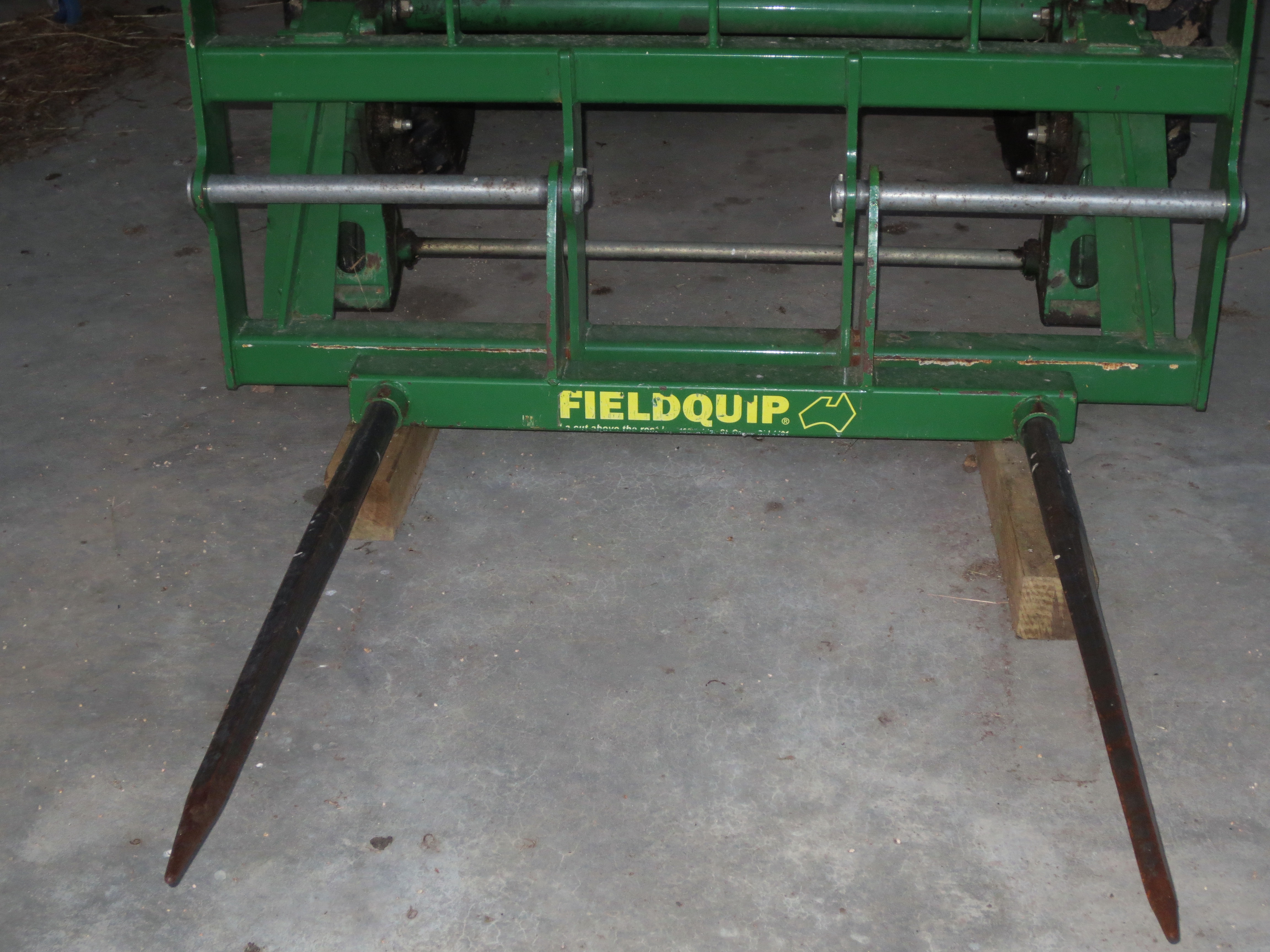

I agree with RickB and showcattle. Your 40hp TC40 will handle a 5x6 round as long as it's 'close up' to the pins of your FEL... extended out beyond the bucket (remembering the weight of the bucket is added to the weight of the 'round' is just asking for trouble. AND that's not taking into consideration the condition of the round of hay.
Seeing as you've got some sort of quick connect on your FEL, I'd recommend something like I have; a 2-in-1 fork/spear attachment where you can swap between either forks or hay-spear.
