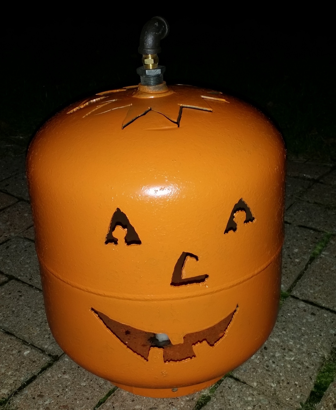

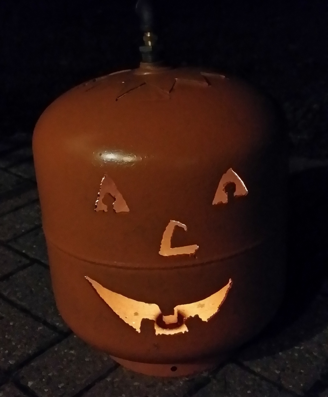

More lately I have made a "lifetime jack-o-lantern":
That one was done with a plasma torch.

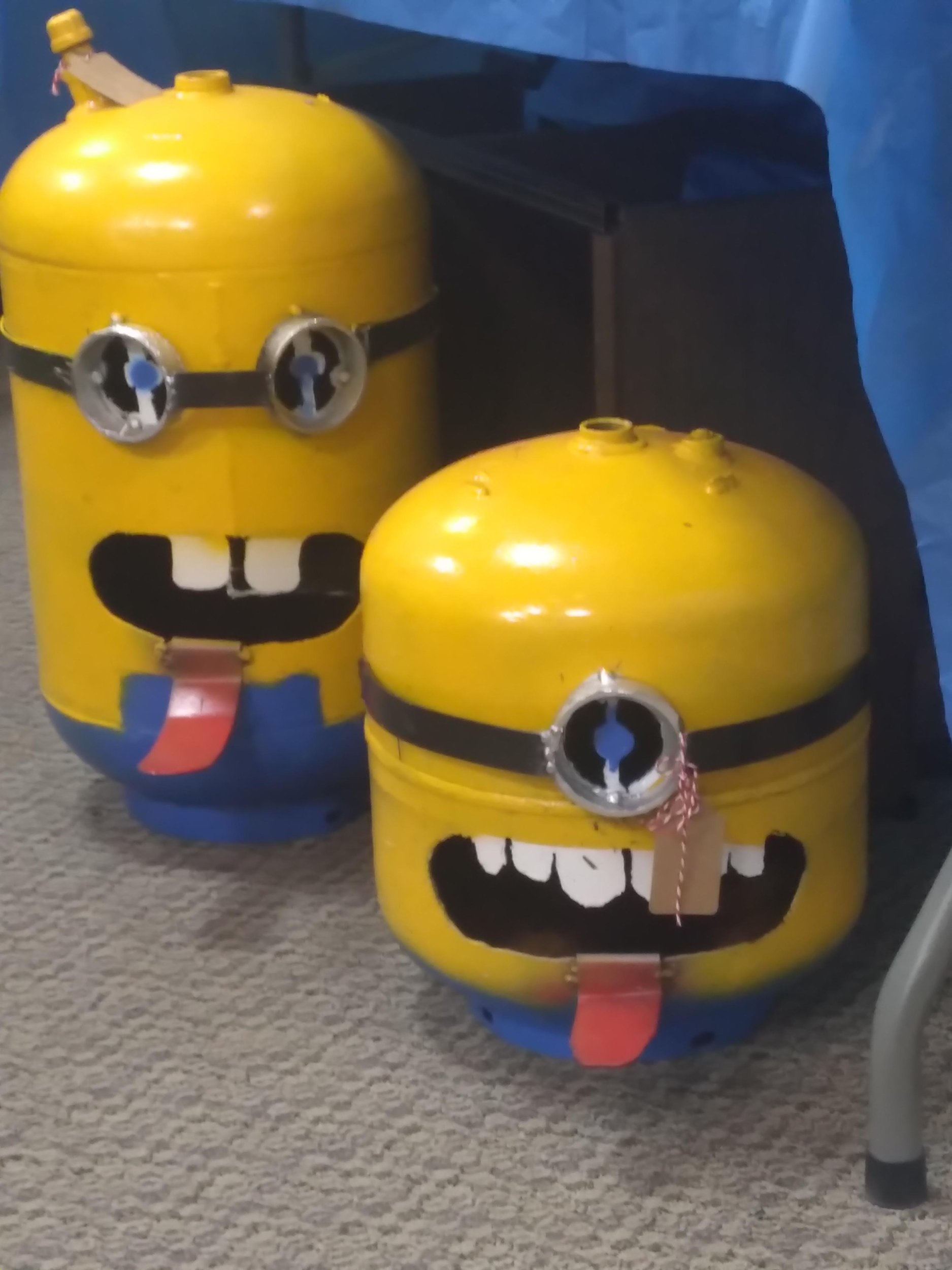

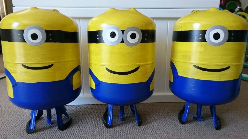

I see quite a few of these around:

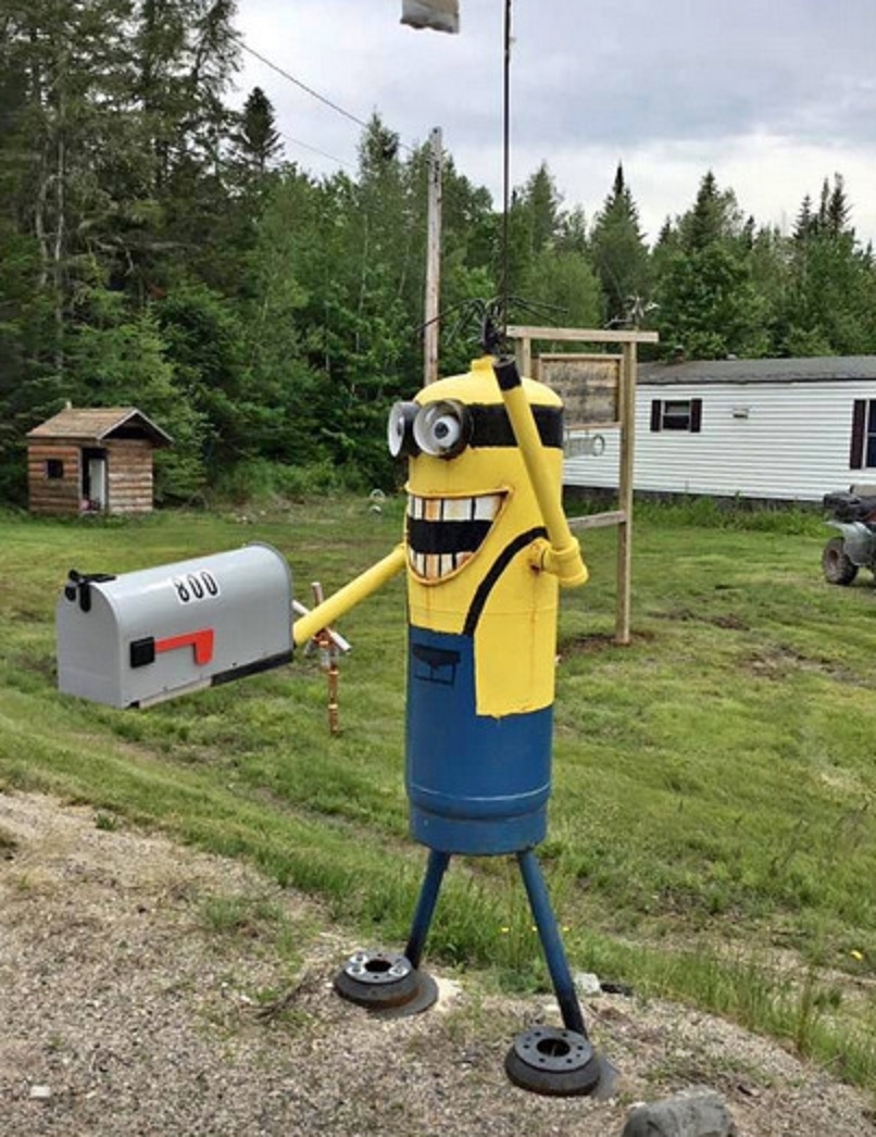

Here's a more practical use:
