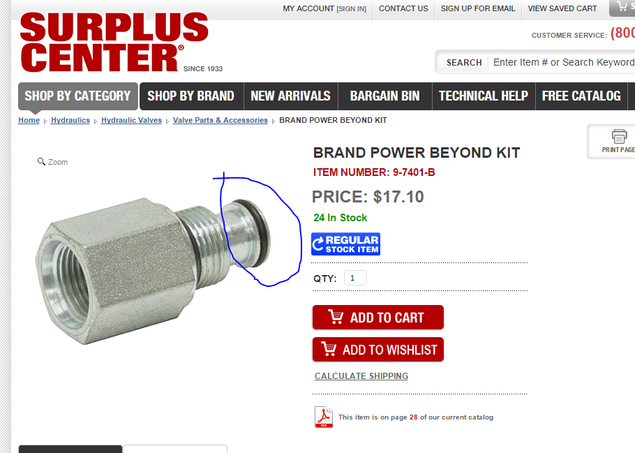

   / Will it work? #16
If an OC adapter with a plug installed where hose is intended to fit will convert a spool valve to CC then why did engineers fabricate a CC adapter why not just install a plug? Notice the absence of the seal on 12C which is an open center adapter vs seal(parts key 10) on CC adapters(12A & 12B). Maybe the older type valves(60- late 80's) that I had experience with are different than convertible(oc io cc & vice-verse) valves built today.

   / Will it work? #19
J_J
Please accept my apology.
After thinking more about PB adapters which came into wide use after I left dealership and I determined I was thinking incorrectly. Plug(parts key 12C) in photo I posted earlier isn't a PB adapter but simply a plug utilized before PB adapters were widely utilized.:mur::mur::mur:
After viewing close up of true PB adapter I see it has same type seal(encircled in blue) that if used in a CC configuration can fail causing CC to revert to OC. This seal that can fail on a CC adapter plug is what had me mixed up as I've previously in yrs gone by diagnosed several of their failures.
Again I apologize,Jim
