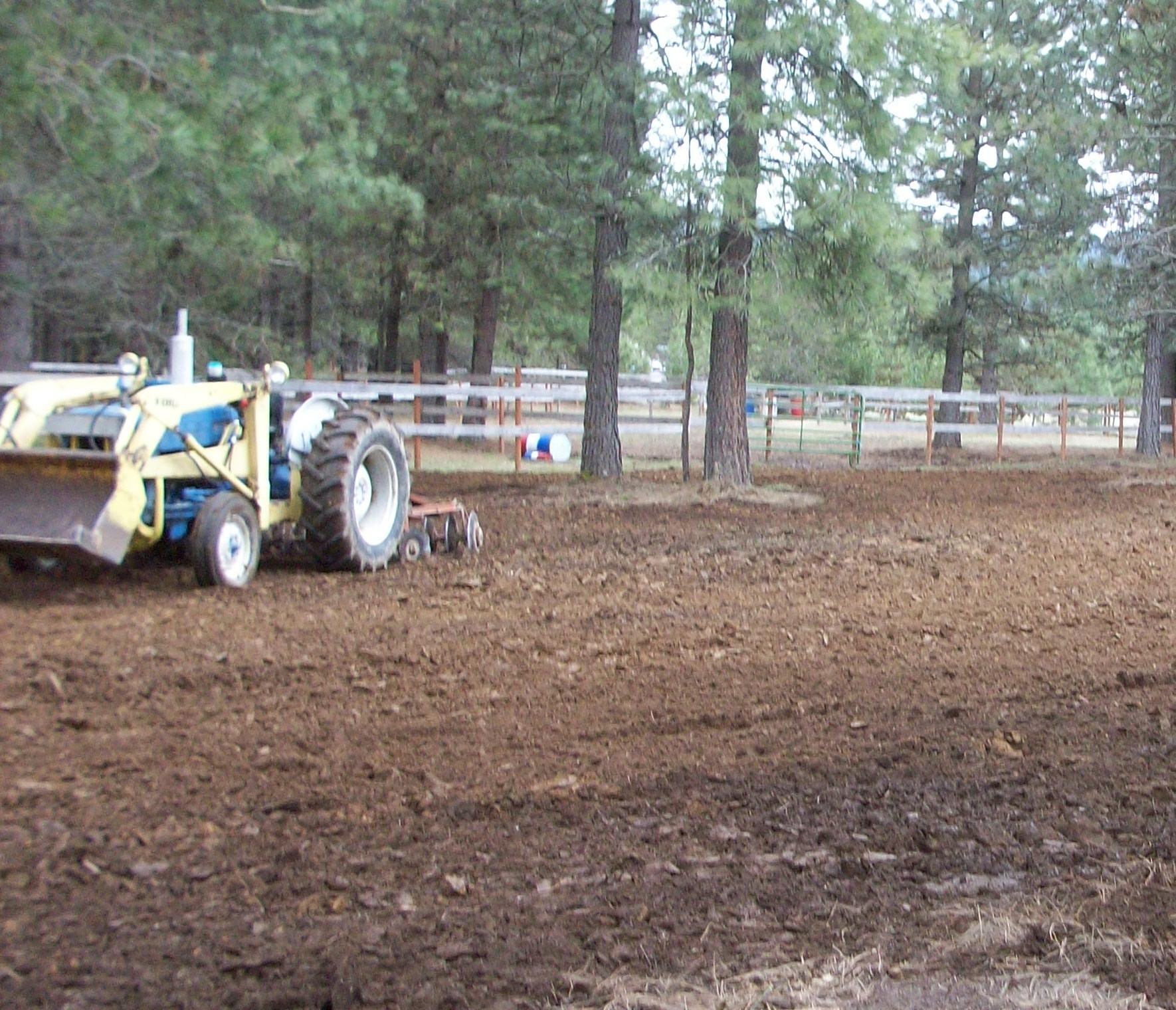

Will my L3130 pull this disc?
   / Will my L3130 pull this disc? #11
I had a L3130 HSt,I think you would struggle with that disc.They pull very hard.I ended up with a roto-tiller for mine.Borrow or hire the bigger tractor.
Looks very similar to the one I pull (interco 20 disc) with the ford 3000 -no problem, tilling and discing 006.JPG Isn't that Kubota 30 hp 4x4- I would think the first time through it would (work) the engine , but on the following passes shouldn't be a problem...
If it were me i would go for it . If it is to much drag -lift the 3 point a bit and try and not disc quite as deep until the soil breaks up.
and if that doesn't work well then it's time to get something bigger.
One more thing i have an old ad showing the ford 2000 30 hp 2 wheel drive pulling a disc at least that big .. i just don't see why it would be a problem...
