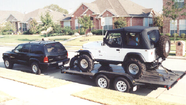

Attached is a pic of "Towing with a 1/2 ton".... I've taken this setup to Colorado & back several times (~1900 mi round trip). Mileage was poor & some steep slopes were SLOOOOWWW going, but it works! Not sure how many of you folks are familiar with Colorado, but took this up the "Million Dollar Highway." Definitely interesting..... /w3tcompact/icons/eyes.gif /w3tcompact/icons/smile.gif
