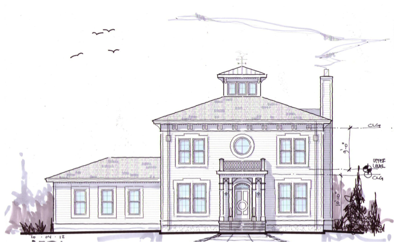

Thanks for all the comments guys. I've spoken to the builder about the issue and he told me not to worry and I do trust him as he is a friend. He told me the lumber is vertical and dries quickly. He also uses DryGuard OSB which he told me is good stuff and water resistant. I just wanted to get some different opinions on the matter. I still cringe when it rains. Hopefully it will stay dry here in Michigan for awhile..
When I first started seeing the walls going up, I asked the head framer about wrapping and putting on the siding. I told him I'd never seen that method before. He said to think about it... If you have a wall laying down, it's much easier and quicker to build the wall, wrap it, put on the siding, THEN raise the wall. We're using Hardiboard by the way. I guess this makes sense. And for those who asked, it is a stick built house. I asked some of the other framers about the head framer and they all said he has years of experience and does great work.
Hopefully they finish the framing sooner then later.
Here is what it will look like when we're done...
