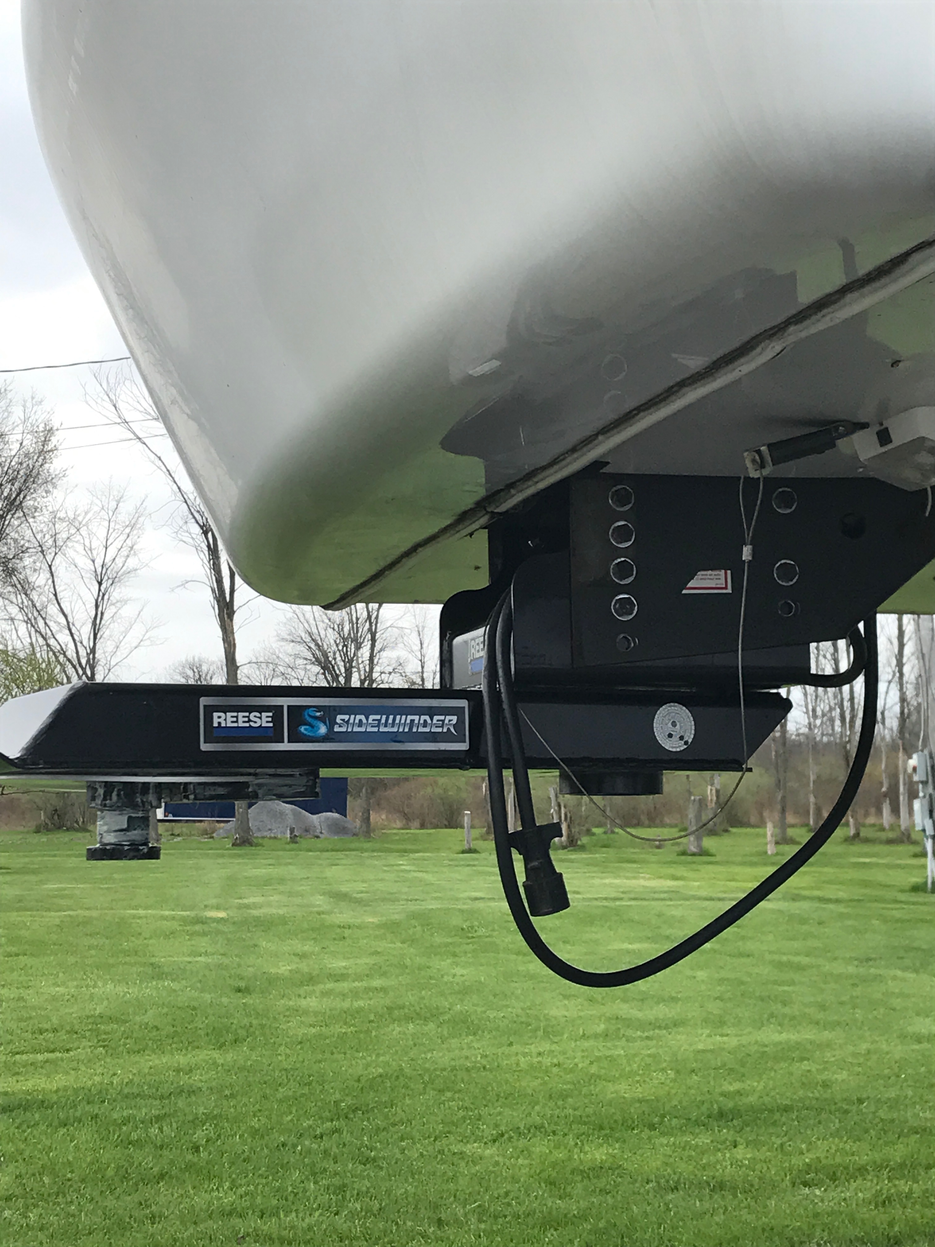

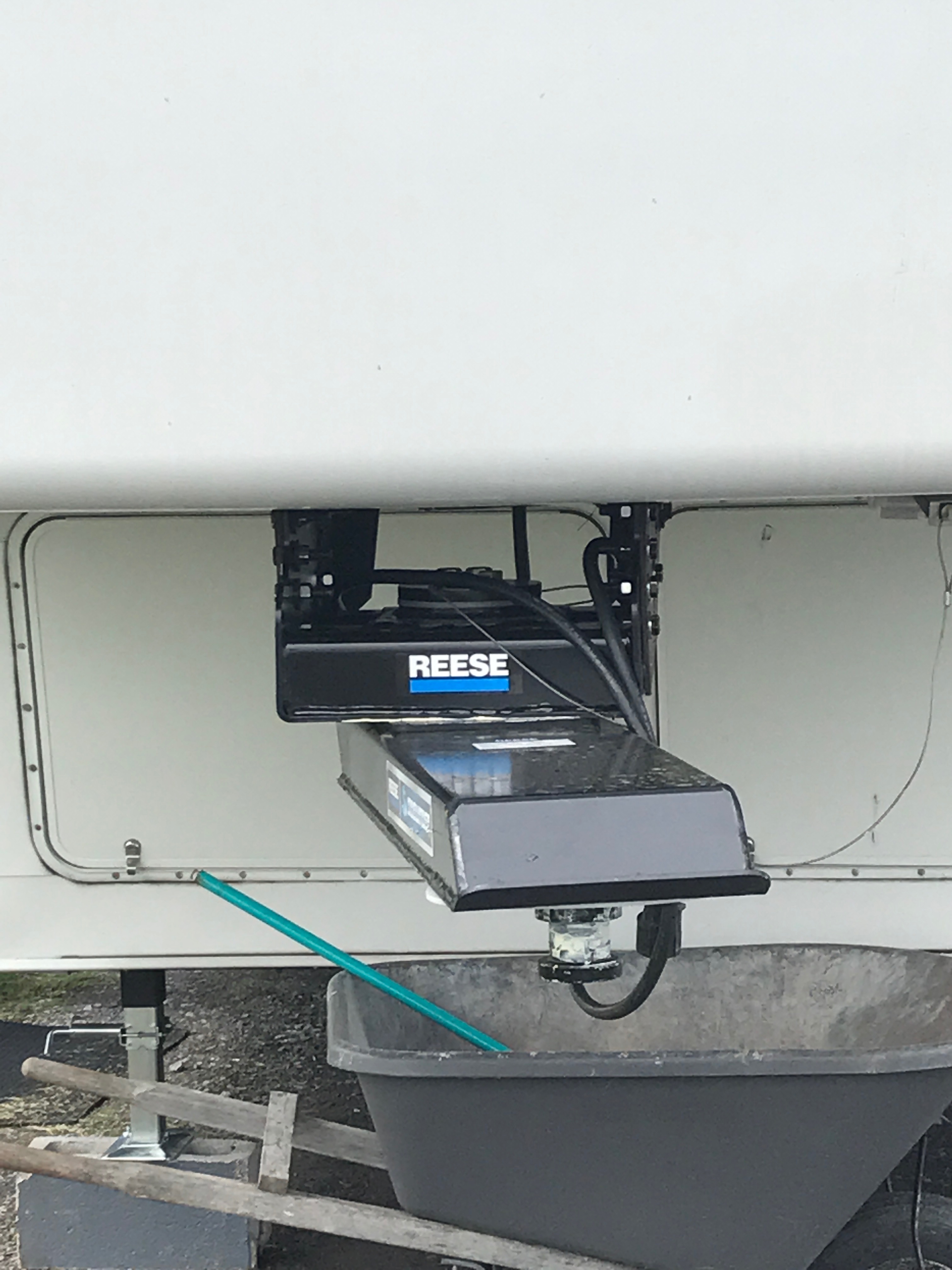

The verdict is in. At least partially. Install went just fine yesterday. Assembly was fairly easy. Fortunately I have forks on my skid steer. I lifted the assembled unit up into place while a friend got bolts inserted. Then had the compressor handy and tightened all with an impact.
I used the custom wedge. Had it all the way forward and actually had to move it back just a little so that the jaws would wrap around the pin.
I have yet to take it out on the road, but a test in my driveway shows that I can go 90 degrees plus on a turn if I had to. Now there's at least a foot between the leading edge of the camper and my truck cab. But I think if I was on blacktop where the tires could get a good bite it just may roll the tire beads off of the rim!
   / Will this be strong enough? #47
Finished product. Note the position of the pin after parking the trailer. Truck and be unhooked at any angle and then backed into to rehook.
