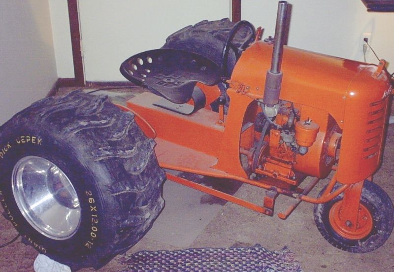

Did a little surfing on tractor pulling. General rule is hitch height must be no more than 1/2 tire diameter. They like 'em on two wheels, but not more than 16" in the air. They use wheelie bars.
Check out anything affiliated with the National Garden Tractor Pulling Association if you wanna laugh. /forums/images/graemlins/shocked.gif
Russell in Texas

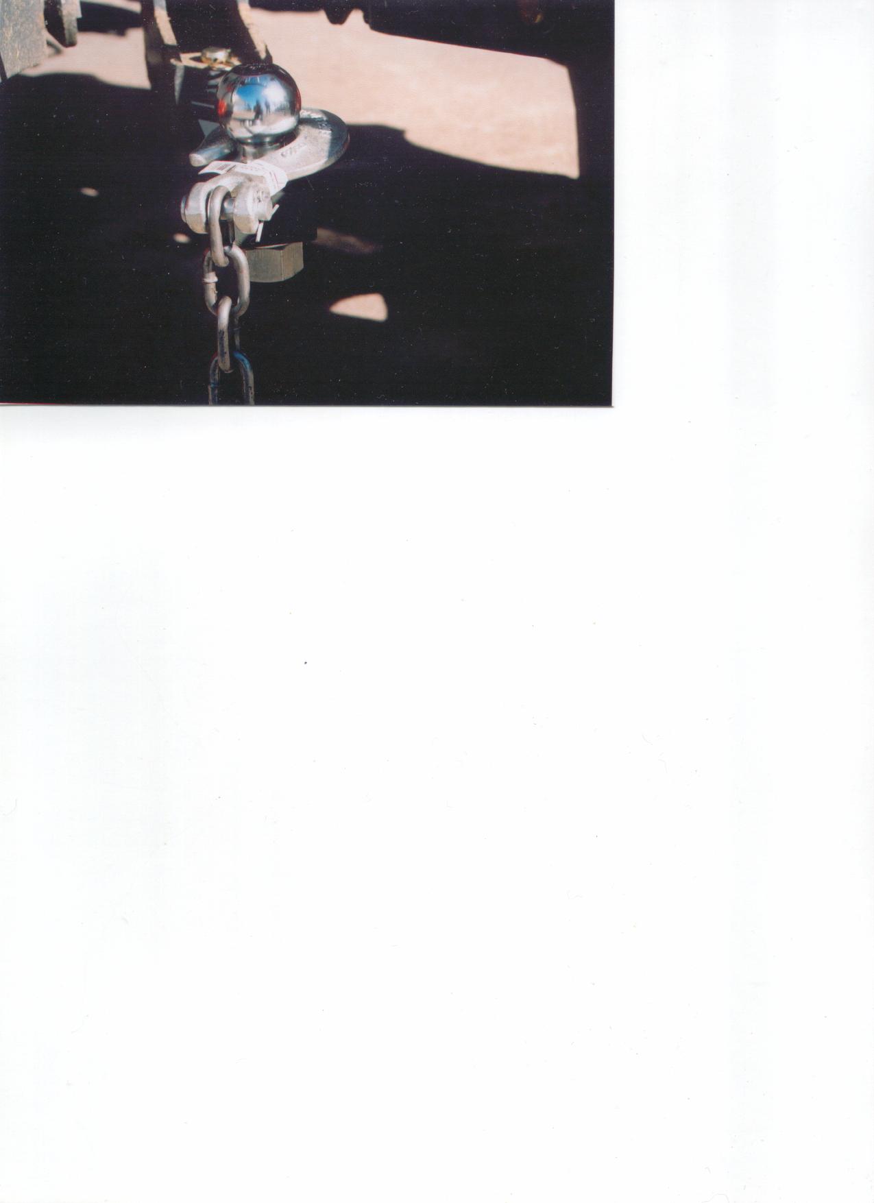

Here are some pics. Finally got the pics scanned. Sorry for the quality. I'm sending my digital Camera to be fixed.
