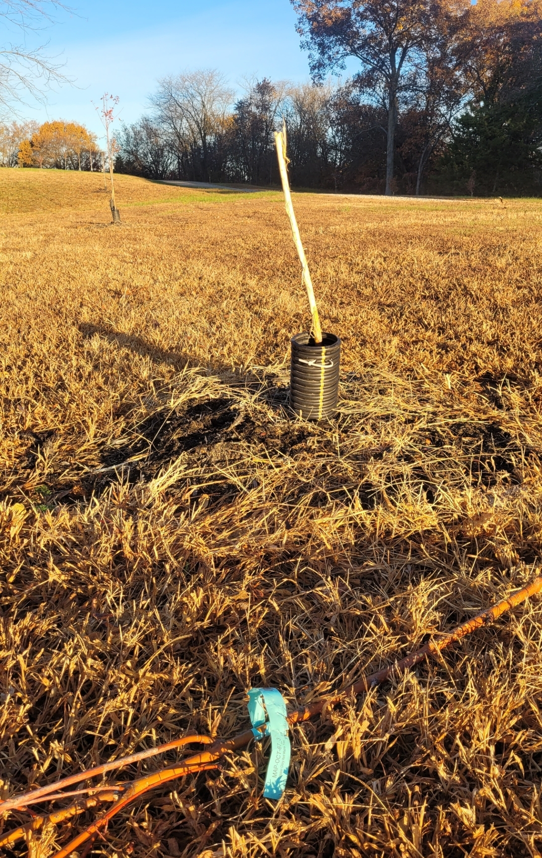

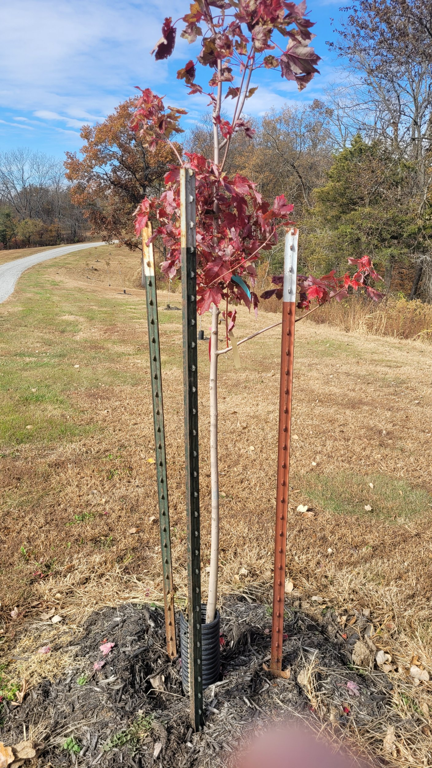

Looking for suggestions to protect about 60 maples from deer rubs. The easiest and cheepest thing I can think of would be 3 t-post in a triangle around the trunks to keep the bucks from being able to completely destroy them. Picture attached. The deer were eating them down to the ground every year. This spring I replaced them all with trees that were taller. They can no longer eat the tops but last night a buck took out about 10 of them with his antlers.
   / Will this work? Need to protect trees from buck rubs. #2
Around the 3X T-posts, 48-inch high welded wire fence wrapped and tied with zip-ties works. We've done this for years. Deer will both rub and eat the bark or the wood destroying your trees.

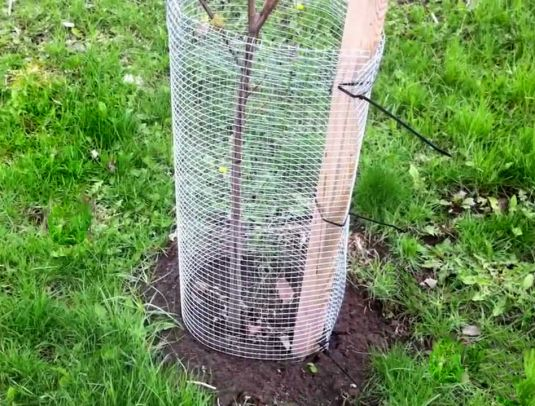

Planted a small peach tree the other day and put a cage made of field fence around it, with a t post support.
The deer just nipped it through the openings.
Had to wrap mesh around the fence to stop them

Use the 4" corrugated tile/pipe like you have at the bottom. Just make it extend up 4-5'. The stuff is cheap.....less than a buck a foot around me. So ~$5 a tree. A 250' roll would do 50 trees and cost ~$125 from where I buy drainage from
