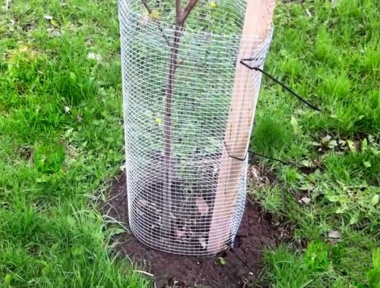

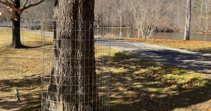

Around the 3X T-posts, 48-inch high welded wire fence wrapped and tied with zip-ties works. We've done this for years. Deer will both rub and eat the bark or the wood destroying your trees.
I have been using 3-4 T-posts around smaller trees for years after losing many trees to Bucks. The T-posts alone seem to work, but in several cases I also used PVC (1/2) pipe from post to post. Drilled a small hole in the pipe and tied the pipe across to the t-posts with wire. The added benefit, if you place the T-posts correctly was that it keeps the tree straight / support against the wind.

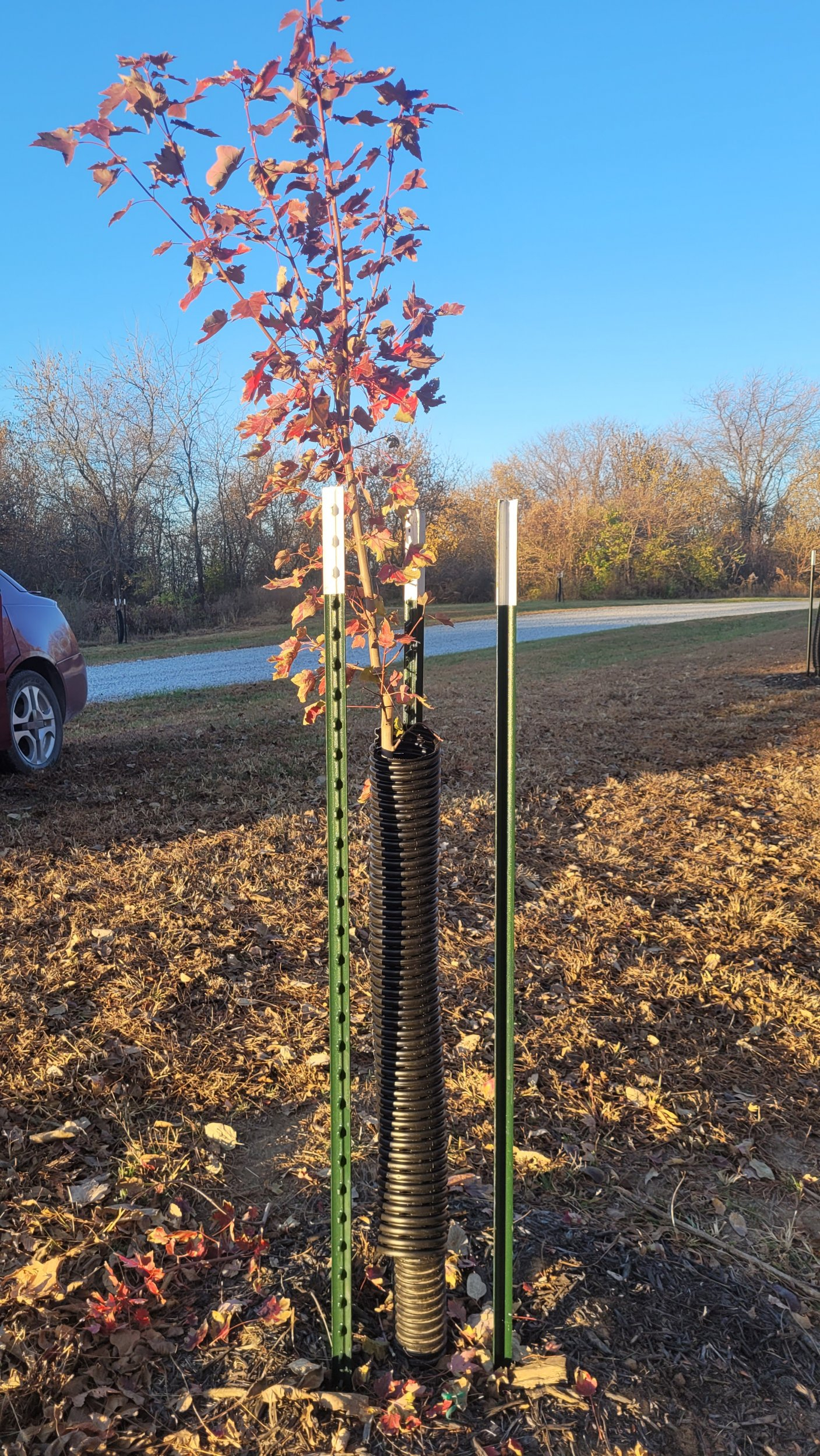

Ended up doing t posts so they can't push them far enough to snap them and corregated pipe. A lot of work but in 2 days they took out 15 of the 60 I have down my drive. About $$1,000 worth of trees at the current size.
Only question on the pipe is heat trapment being black. I'm wondering if I'm going to have to remove them in the spring once the antlers drop so I don't overhead the trunks. It's perferated pipe but still not sure on that. View attachment 768708
