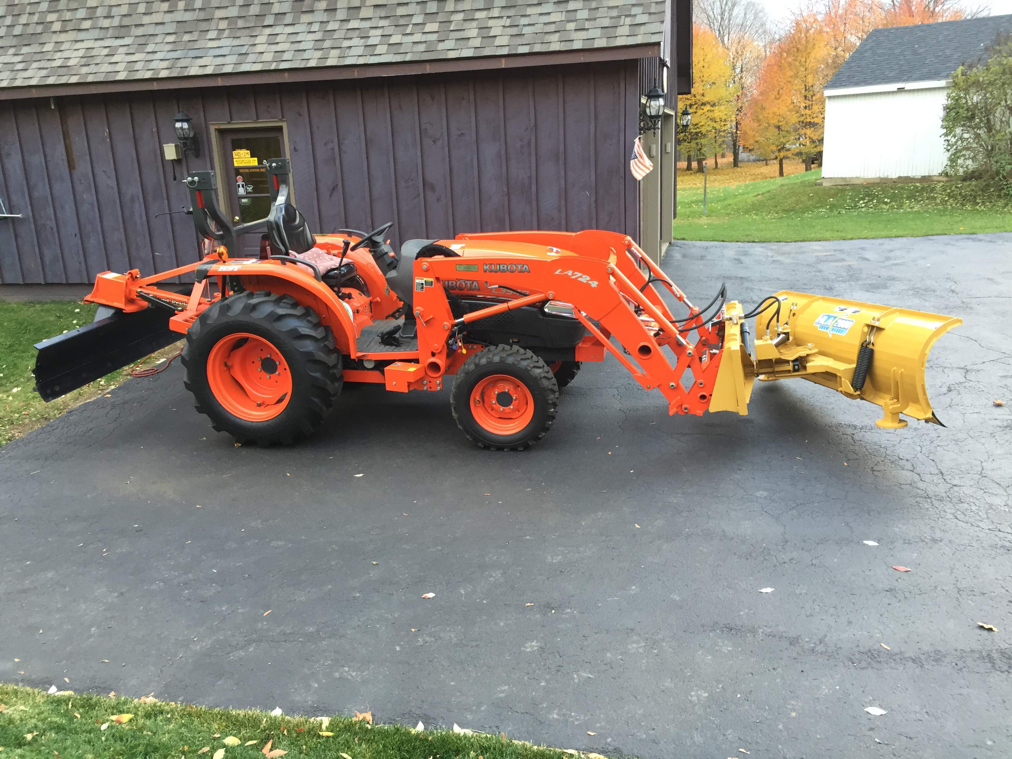

   / Will this work? #20
I use both,not always at the same time.Rear is nice for pulling away from garage doors ect.My tractor is heavy enough that I can run both a the same time if not too deep.Rear blade will scrape right down to the pavement.
I have upgraded since this picture to a 7ft.medium duty rear blade;8ft.Curtis on the front.
